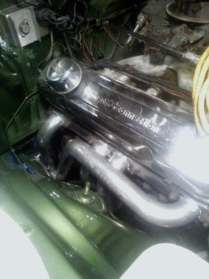

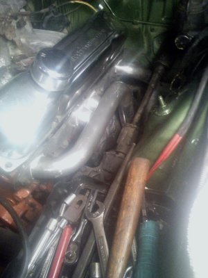

    I just changed out the rusty headers on mine. I went with Flowtechs ceramic (made by Holley)
    A lot cheaper than the TTIs. Look good, not a bad install at all. 383 4 speed. Original gear reduction starter. The only things....my heads had the original studs..had to clean out the bolt holes on the flanges with a drill bit. #7 tube needed a couple taps with a hammer to clear the Z bar...nothing drastic. Tube for #4 rubs the inner fender. I have a small leak on #2...shoulda dressed the mounting area to the head. Overall pleased and they sure look a lot better than the old rusty headers. But all in all.....original HP manifolds would work as well, and make life easier.

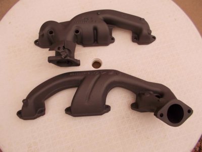

    Any powder coat out fit can ceramic coat them. Here is a set I had done, the guy wanted the heat riser left on it. DSCN0945-800x600.JPG
