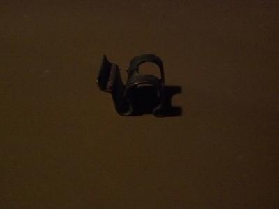

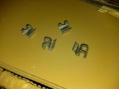

Here's the clips Im talking about. I only have 5 with the car. Any idea how many I need, and where to get them?

Ok, found them at RT Specialties. I'll give them a call today or tomorrow. Any offhand ideas on how many I need?

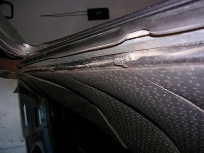

I found 4 or 5 on each side of my hardtop but my buddy brought more with him when we did the head liner. They basically held it in place until the glue dried but I left a few up there as I found it.
SDteve those clips hold the metal trim in. the ones that hold the headlinder in place are C shapped. The headliner isn't that hard to put in, but it is a PIA just trying to get all the wrinkles out. I've seen alot of show type cars with wrinkly headliners, so if you can have a shop do it, it's well worth it. Luckily mine was alreay done when I got it.
