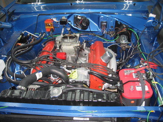

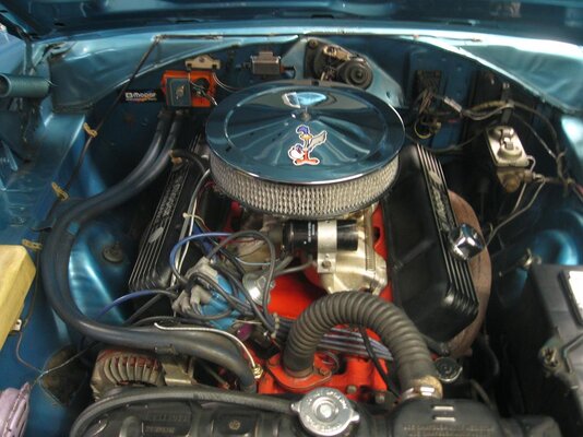

Putting back together a 70 383 4 speed Road Runner for a friend & need to run the heater hoses (one is 1/2" ID the other is 5/8 ID) to the water pump housing. The heater box was out of the car when I was putting it back together, but not sure which hose goes where or what are the correct places on the W/P housing. Both fittings on the housing were plugged (actually, there are 3 spots the fittings could go) Car was pretty much a street driven drag car when it was bought, that's why the heater box & misc. other items were off the car. Also, this car had a "factory" looking Mopar/Chrysler radiator in it & the upper & lower hoses for the radiator were on the driver's side, BOTH of them. All the ones I've seen have the upper hose on the right (passenger) side. Were some like that? I know someone here can help me out. Thanks, & Merry Christmas!

Thanks for the info Ranger. Now that know where the heater hoses go & the stock radiator has both outlet on the driver's side, that will help me a lot. I'm guessing the cars equipped with the "Max Cooling Package" or A/C had the upper hose on the passenger side. P/S, the heater hose bracket location is very helpful also. Believe it or not, I found both of them too. Thanks again for all your help on this.
Not positive, but I think you might be right. I also think those might have had a 26" radiator as opposed to the 22" in my picture.
