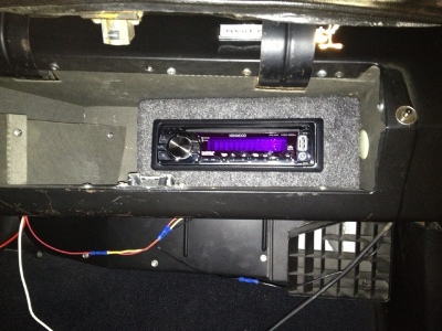

nice shot of the clock. I've got the blank too. I've had two '69s with the factory tach, and neither worked. How did you mount the radio in the glovebox?(got a pic? :D ) Was thinking about doing that myself. I got a rare factory Dodge radio from roadcuda for the dash, but wanted at least a cd player for some tunes.

Sure thing basketcase! Here are some pics

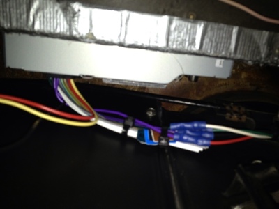

Sorry about the wires but im in the process of adding that front speaker so I have to redo the wiring, but you can see that I have a custom box that the radio casing slides into. I had to cut the back out of the glovebox for room. You can this this from the second picture.
pretty slick! my only trouble would be the crap I keep in the glovebox.

LOL yea I keep my original car book and a few fuses in the glove box. I added a radio that had iphone/ipod integration so I have a few cables as well. But they all fit and love it!

welcome even though i joined after you. i was wondering if you could describe how you built the custom box for the radio in the glovebox? and any tips you might have picked up doing it. i just replaced my radio with an aftermarket one. and i dont like how it looks rather have the factory one in for looks. and does anyone know where the ignition/accessory wire should be ran to? right now i just used a fork terminal n wedged it inbetween a fuse probly not the best idea im thinking. thanks

LOL you guys are a riot on this site :) Sure I can give details on the hide away radio. I don't have the dimensions but the back of the glove box is trimmed out. The box is made of wood and covered with a fabric. The hole is cut to the size of the radio brace. The brace fits and pries into the wood to hold in place. Once that is done I ran the wires and spliced into the speakers. I have the power wire running to the fuse box. Once all the wires and antenna are plugged in I pushed the radio in the whole way. It's a close fit but it works out great!
I just purchased a front speaker and it comes tomorrow. I ordered an antenna split-er so I can run it to my hide away and factory radio. Then I will run the speaker wires from both. I know to only run one radio at a time, but figured it would be great to be able to use the factory radio at shows :) can't wait to get my car back together and take a cruise! I also installed a sunpro tach on the column so can wait to see how that works!

So I got back in town and my new speakers arrived with all the cables I needed. I spent the day modifying the speakers to fit around the heat control unit. I have both factory and aftermarket radio's connected and working. I ran all the wires for the new tach and it works! Also the factory clock is working like a champ in my gauge cluster area!!! So I would say it was a success! Now just waiting for a good day to take it for a drive!
