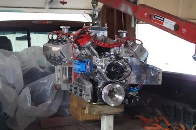

ok....572 Keith Black aluminum street block with no provisions for motor mounts-because of dual line milodon oiling system/4.50 bore/4.50 stroke/balance knife edged scat crank 4340 non twist forged/oliver bullet steel race rods 7.100[4340]/diamond pistons/11.5 to 1 compression[ pump gas motor]/bullit solid roller cam[dont have cam card in front of me]....around 312 duration /692intake/682 exhaust lift/isky ezroll max solid roller bushing lifters/smith brothers 1.45 wall push rods/milodon gear drive/milodon 9 qt oil pan with steering link hole thru it & dual line swing gate pick-up/milodon windage tray/milodon high volume oil pump/ati super damper/mechanical mopar perfomance water pump/stage v big valve aluminum heads-custom 2.40 titanium intake valves-1.90 stainless exhaust valves-comp port & polished by tim banning[forhemisonly][heads flowed intake @ 28 " ....750 lift ..[485]...exhaust @ 28" ...750 lift ..[277]/stage v roller 1.6 rockers and billet aluminum stands/comp cams 944 pacoloy double valve springs1.575/205-760 lbs/1.550 spring seat cups/1.5-1.550 titanium retainers/11/32 super locks/10 degree lock/locking caps/.309 locking lash caps open[ray barton dominator 9 1/4 high single plane intake/super sucker poly 1 inch spacer/12.50 pro-systems dominator/msd pro-bullit distributor/msd 6al plus 2 box/ msd blaster hvc 11 coil/taylor 10 mm custom spark plug wires/TTI 2 1/4 x 4 inch collector polished ceramic coated in and out/3/8 aluminum motor front plate/ptc 3500 stall 9 inch convertor/727 reverse manual race trans-all heavy duty a with gear vendor overdrive/dana 60 rear with 373 gears...had 4.30 but was too much for street/20 gallon fuel cell in trunk with mallory 250 gph fuel pump/mallory spin on filter running 10an to 2 port mallory fuel pressure regulator then 8 an to carb/8 point cage ..3900 lb roadrunner....ran before in 2010 ...10.37/128.82mph

Thanks for the detailed engine/build run down, sounds like that thing will be awesome for sure, wow I missed a hole chit load of stuff...LOL, downright freaken' impressive build, should have great Dyno #'s, looking forward to results & another great new video too... good luck happy MoParing

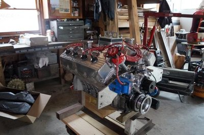

went over and picked her up yesterday......called his son who has 9 race motors to finish by april......so no dyno till the beginning of april

That thing looks a beast George! That looks like some extra hardware on the front end, on both the water pump and crank. What is that needed for George? And that blue box, is a magneto setup?
on the crank.....ati super damper....water pump is a electric water pump just for the dyno but will go back to mechanical moper water pump......blue thingy is the 44,000 volt coil.........
