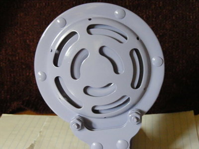

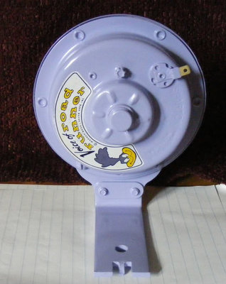

I looked around at the different paints to paint my horn and found a reference on another forum to using Testor model paint. After seeing $30 for a 1/2 pint and $20 for a spray can of "restoration" paint, $4 for a can at my local hobby shop sounded pretty good. I tried it today and I gotta say the color looks right to me, although it looks a little blue in the pics.
I sandblasted and wirewheeled the old paint off first, sprayed some duplicolor primer ('cause I had some) and some duplicolor white (again had some) as an undercoat to make the purple a little brighter. Testors #1234 purple in the spray can applied lightly. One thing about the Testor paint I noticed was it went on wetter and thinner then the usual rattle can paint I'm used to. This explains all those crappy looking model cars back when I was a kid.
