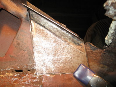

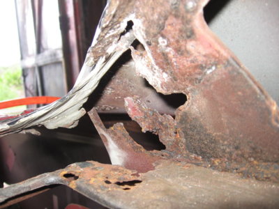

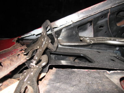

IMG_0101 (1).JPG IMG_0104.JPG IMG_0106.JPG Here are some pic's you will need a Mig welder to do the work. A mini grinder to cut the metal. Got my welder for EastWood. Part of this area is the quarter and the roof is the other part. Have seen this area replaced On other runner's by making the piece with a metal brake or bead roller. Some one had tried to make it all out of Bond o on this car and man what a mess. This one had leaked for so many year's even part's of the inner frame was gone as you can see as well as package tray. I would get with some guy's that have hot rod's in your area and ask them who they used or if they know of someone that can make you piece for you to weld back in their. Their are videos of 69 runner's restored and I looked at a lot of them. Sorry to say having a shop restore a car is not cheap. Doing it your self save's money. You can learn how to fix these area's your self. What you save on labor at the shop you can buy the tool's needed to fix the car. Or can get body panel's. Their are some patch part's for these area's at AMD. Good luck post some pic's of the area you are concerned with. Harbor freight has Mig welder's that are Ok that is a wire feed rig with argon gas. Russ.
