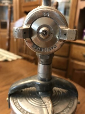

Well. I've been a automotive painter for 20 years. I learned to paint from a older fellow using a devibliss JGA. My hats off to you on getting that cup and spray head inside to door. Great job.

Thanks! I appreciate that! I've been painting Since I was 17. (Now I'm 65) sometimes you get lucky sometimes you don't. you have a good day! :thumbsup2:

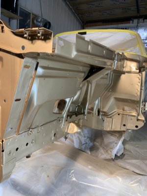

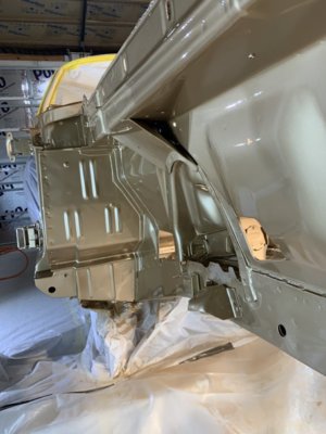

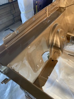

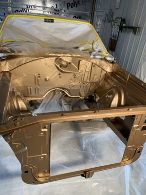

It almost got the best of me today. it took me from 7 o'clock this morning till about 6 o'clock tonight to get that thing sprayed base and clear, and the clear and the base actually sprayed pretty good. the clear I had to play with at first with the first coat, but the second coat I kind of let her have it. it looks a lot better than what the pictures show-it's as slick as snot on a door knob! your buddy, Raymond
