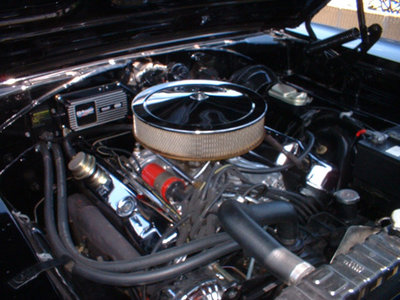

My wagon with a 440 engine runs at 210 on my Autometer gauge and it has me a bit concerned since I will be using it to tow my Runner to Vegas later this month.
The sensor is plumbed to the side of the block because my dash gauge is in the water pump housing.
So is it REALLY 210 or is it reading higher because it is right next to the bang bang going on in the cylinders?
My dash gauge is at a reasonable position.
My radiator is new.
The engine is a freshed up tried and true 440 form a friend's charger that never ran hot.
The thermostat is a 160 degree unit and brand new.
The antifreeze is a 50/50 (self blend)
Do you guys think the gauge would read lower if I put it into the top of the water pump housing?

I think your in a hot spot :yesnod: I can't see one in the pic but I would put a shroud on that bad boy before I towed anything.

i did spal dual fans with shrouds.......worked for a while them threw them out and went back to the stone age original equipment and runs......160-180 with a 160 stat.....too cold.....went to a 180 and runs all ay 180-200....stock MP water pump/flex fan/shroud.......work"s great.......make sure you drill a small 1/16 hole in thermostat so you system dont get air bound

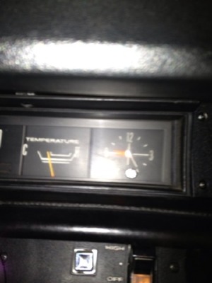

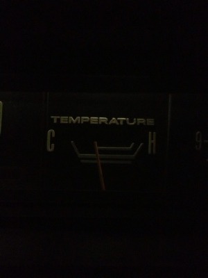

Here is a picture of what mine is staying at
FEBEA60B-C867-426D-A654-319B4FE5A1E7-2694-0000028546908D28_zpsa368d6d3.jpgDD41780A-77D4-4969-A2EC-B5783ACBF300-2694-000002854AC815DC_zpsd4757033.jpg
Also could someone explain to me the upper U shape before it gets to "Hot"? I'm just trying to get a better understanding of this gauge instead of installing a new temp gauge to make sure I'm not running hot.

22,251
2,495

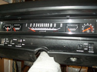

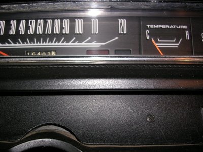

Like said above its the operating range but look at the difference in gauges. :huh:
300
put a manual guage in for the piece of mind. mine stays at 180-190, unless its 90+ and stuck in trffic.

Wow that is crazy how mine is off center. I was wondering why it was off... hmmm.. Well I guess it's running fine if I go by your gauge.
10,552
308
I have both the stock and aux. gauges. Normal temps are around 185 with the factory gauge needle more or less pointing straight up.
