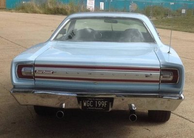

Hi Guys,
I am very interested in buying this 1968 roadrunner with 383 in the attached picture but i am not sure about the correctness of the rear end as far as originality is concerned.
Are the decals correct?
Does it look OK?
I am in the UK by the way, so is the car.
Thanks in advance
Ashy22
besides the decal on the driver's (left) side, it looks correct to me, but I'd loose the anntenna. should be on the right fender.
10,538
281
As far as I know the only letters on the rear panel are the Plymouth name and no bird decals. If that bird is in color that is not correct for '68, they should be in black and white. The colored birds started in '69.

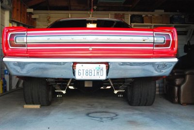

The decal on the left driver side is not correct, The other side has the emblem and running road runner. I've attached another example.
now that's a good looking Butt(even if it is Red:acme:)
Steve, yes and no. In '68 you got the black and white birds on the doors,decklid, and dash...unless you ordered the dercor Package, which got you the stainless tailpanel on the trunklid and chrome tips, and got you the colored running bird on the tail panel.

It's missing the black paint stripes on the finish panel and in the taillights. The back window looks like a 4 door car to me, anyone else think so?
I think its just the angle on the rear window pic, the trim goes into sharp corners at the bottom
It doesn't look like a 4 door to me either.
Wrong exhaust tips.

Just found out that it's got no power steering and no power brakes :(
Is this bad or doesn't it matter?
I would too, and unless you find something bad, I'd bring this one home.
Sounds like a mans car :lol: Mine is all manual, it stops fine but the steering is heavy in parking lots, but I have a much heavier engine over the front tires. Wait for some more opinions.
I actually prefer my manual steering. but I don't have your tight streets. but after not being able to drive my for over a year I may change my mind...
actually the manual brakes and steering,four speed was the way the '68s mostly came IIRC. big engine,no frills, pure American muscle cheap price.
