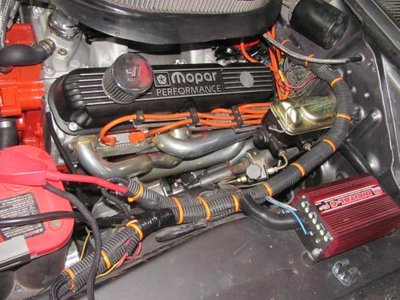

The headlight relays went in without a hitch. I ordered the kit from crackedback with a fan relay. I'm hoping on picking up a 727 dust shield later this evening so I can test things out. Right now, I've still got the starter dropped. I did try the headlights and the fan to make sure they operate but I still want to try them with the car running so I can see if there's less of a draw down on the electrical system and if the lights seem any brighter. One of the nice things about these kits is that they are custom made with all of the wire lengths you need. Everything is fused. No need to hunt down the right relays or relay sockets. If they work out as well as I've heard, I'm sure we'll be ordering kits for our other vehicles.

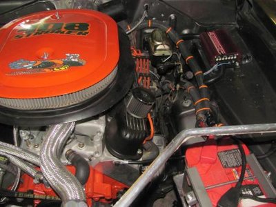

Now that the headlight relays are in place I started to bundle up the rest of the wiring.

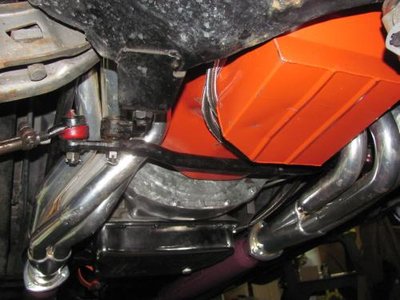

You guys may have noticed that the left side spark plug wire holder has the back two wires routed on the opposite side of where most people would position them. It was the best way I could find to keep those wires away from the header.

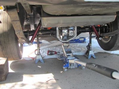

I just can't win. Spider brought the drive shaft down this morning. It looked good. But the rear end yoke had the wrong spline.
Spider took my old yoke back with him to make sure that there won't be any more mistakes.

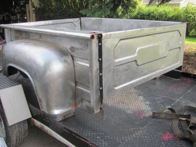

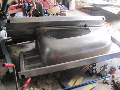

I ordered a new fender for the 'Lil Red last night. Yesterday I finished sanding the box components. Today I'll re-assemble the box and try to get it to the painter.
I ran out to the farm yesterday and picked up more of the parts. There's some serious work needed to be done in the near future.

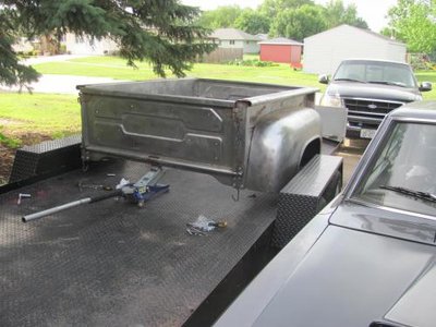

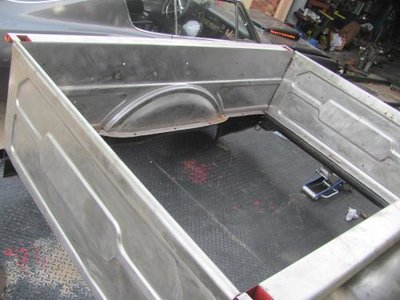

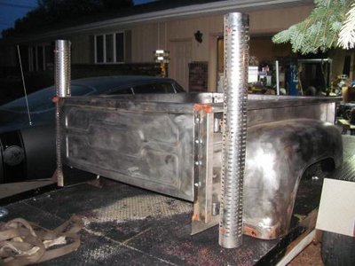

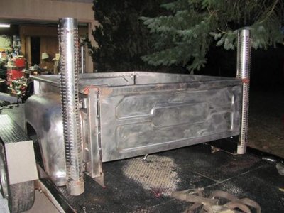

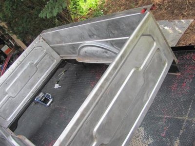

Well in an attempt to stay busy, I've re-assembled the truck box. There was heavy pitting behind the wood. I'm hoping some POR-15 will prevent it from coming back.

I know that this is supposed to be my Barracuda build thread but I've sidetracked over to the truck while I'm waiting for the drive shaft. It's been apart for so long that it's taking me awhile to remember how everything goes back together. I put together the stack brackets and hung the stacks. Tomorrow I'll have to get some new stainless bolts for the shields.

Spider finished the new drive shaft today! I ran to Duncan, Nebraska to pick it up asap.
Well, it fit like a glove. I had it in in no time after getting home.
Eager to take the car out for it's new maiden voyage, I fired it up and let it idle for a few minutes while I topped off the transmission fluid. Before I had a chance to leave the driveway I noticed a puddle forming beneath the car. The transmission AN fittings were leaking near the radiator. I shut it off and crawled under the Barracuda to see what the problem was.
It turned out that I hadn't gotten them tight enough. A few minutes of wrenching and I was ready again.
As I backed up I could hear nasty u-joint noise. I pulled back forward and shut the car off again. I was pretty sure that I knew what the problem was. After jacking it up in the air I confirmed my suspicions. The front u-joint was rubbing on the drive shaft loop. I added a shim and was ready to try it again.

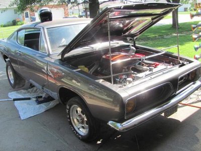

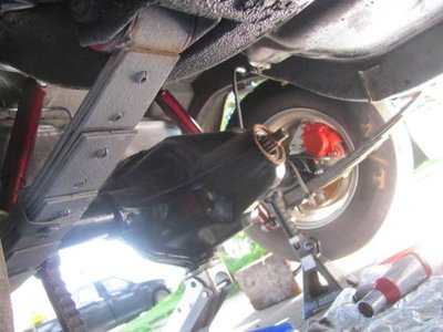

I started today by tackling the transmission leak.The transmission bolt that holds the dipstick in place was obviously positioned there by a GM engineer working undercover at Chrysler corp. Either that or by the guy that would eventually go on to create the Yugo. After an hour of struggling I had the bolt out. It wasn't so bad. - Nothing that a skin graft can't take care of. I didn't realize you could dislocate your wrist though.
I'm regretting the fact I hadn't cleaned out the garage yet. As enjoyable as it may be working in the driveway with the neighbors as spectators, I had the added benefit of the rain saving me time by letting me shower as I worked. I keep telling myself that things could be worse. - I could be working on a Ford.
The leak was caused by an unseated seal on the dipstick tube. Nothing too dramatic but enough to make me want to slap myself (if I could just get my wrist to snap back into place).

As I'm typing this from the comfort of my garage, I'm looking out at the truck box that's still sitting on the trailer. It's nice to know that all of that time I spent sanding off that surface rust wasn't a waste of time. It was a good warm up practice for all of the new sanding that needs to be done.

Well I finished re-sanding the truck box and delivered it to the body shop. Tomorrow it's supposed to rain again. I need to try to get the rest of the truck in the garage. As much as I'd like to concentrate all of my time on the Barracuda I still have to get the truck ready for paint.
