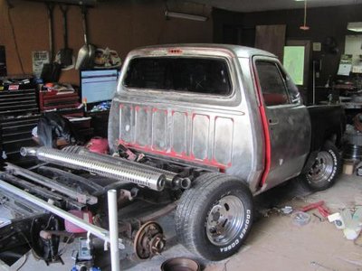

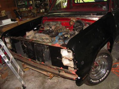

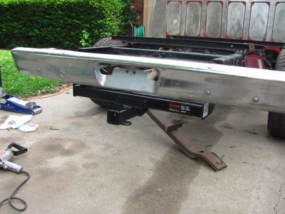

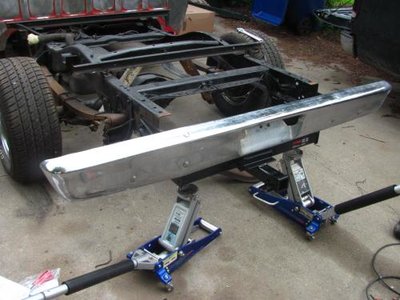

I'm continuing with the 'Lil Red in hopes that I can use it as my tow vehicle later this year. Well the receiver hitch lined up great but I did need to drill a couple of extra holes. I'm not sure yet but I think it may interfere with the factory spare holder.

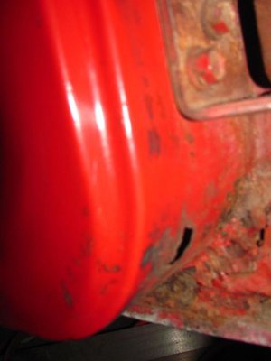

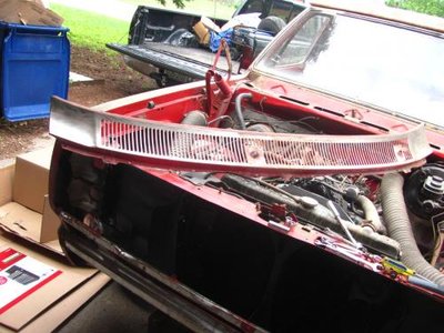

The cowl vent panel had to come off in order to expose one of the hidden fender bolts.

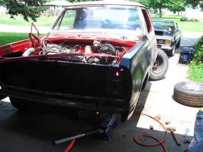

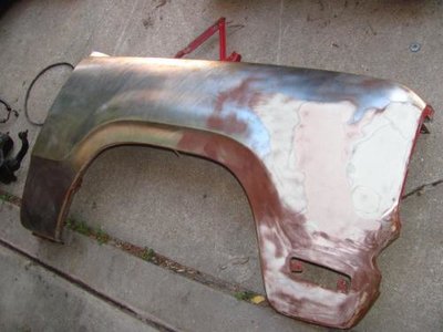

I'm wondering if I shouldn't have torn the entire truck apart. There was a lot of debris behind this fender. I still need to straighten the inner fenderwell and do some major clean up work.

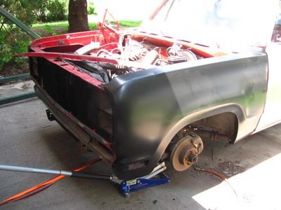

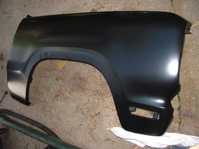

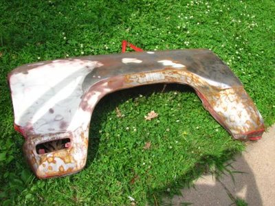

I fit the fender today and it's pretty decent. It fit so well that I decided to replace the right hand side too. I had hit a deer with the truck years ago and there was some bondo in it too. I still haven't bolted it in place because I want to clean up the inner wheel well some more first but I will to make sure everything bolts OK. Then I'll have to re-pull it so we can edge the fender.
The second fender was even cheaper than the first. Only $140.70 shipped from the same supplier. You couldn't pay to have yours straightened for less than that.

The second fender showed up today for the pickup. I should be able to get the truck inside soon.

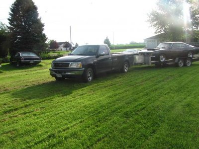

I've got the christmas tree loaded along with the generator to power it. I think that I had mentioned long ago that one of the main reasons for it's purchase was to use it as a car show display. Although there is still rain in the forecast it sounds like it may not arrive until the show is over. I'm keeping my fingers crossed.

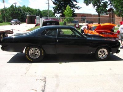

Another car show tomorrow. It's just 10 miles away in Brainard, Nebraska and I always try to go to it because my uncle lives there. Historically Mopars don't do well there. It's more of a Chevelle/Mustang shootout for trophies. But I've resigned myself to being filler in between the contenders. I may take the Duster and the Barracuda both simply because it's so close. I realize the Duster has absolutely no chance of winning because it needs a lot of work but the sound of that 440 never fails to impress the crowd. The two cars with the tree between them is still a cool sight.

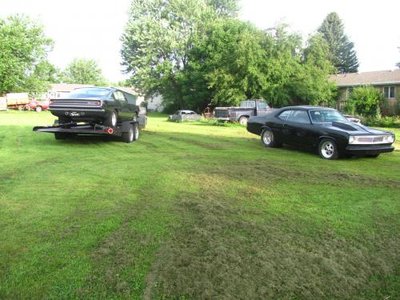

Another weekend shot down the tubes. The Brainard show was OK. I towed the Barracuda there and dropped it off first making sure that I reserved 2 spots side by side. They promised to reserve the second opening for me. Then I ran back home, loaded the Duster and towed it down.
After unloading Dusty I found out that they didn't save my second spot and I had to seek out another place to park. A T-top Firebird was sitting there instead. - Not a huge problem but I was disappointed. The whole reason I had chosen to bring the Duster was so I could park the two cars side by side with the tree in between. Many of the same cars show up each year at this show and a lot of the same cars are repeat winners. This year they said they were going to have judges from outside the sponsoring car club because they have had so many complaints about their own members winning so often. It didn't seem to make a lot of difference.
Even though I hadn't expected to win today I was still disappointed by the judging. They chose to start the grading with the cars that had shown up last. I was still setting things up and hadn't had a chance to do any cleaning when they looked at my Barracuda. I should say 'glanced' because - of the three that came by only one of them barely broke stride as he made a few marks concerning my car on his clipboard. They didn't even bother to give me the time to put my owner information in the Duster before sailing past it. It would have been nice to have had the illusion that my cars were in contention.

It's Monday and time to hit the truck hard. With the 'Lil Red finally in the garage rain shouldn't be a factor anymore. It's a beautiful day. The heat, humidity and rain that were so prevalent the last few weeks are gone. It's almost too nice a day to be working on cars. But unless I want to piss off my painter buddy I've got to make progress. The passenger fender is coming off first.

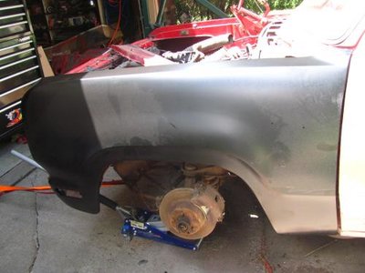

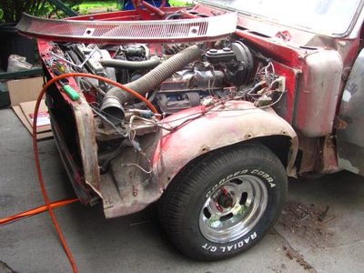

Taking off the left fender was just way too easy. Despite the fact it was bent none of the fasteners gave me any trouble. I'm not so lucky with the right fender. Three of those tin nuts are spinning and one other snapped off. The 3" air grinder should eventually take care of them.
My painter called earlier to get an update from me. If I have to I'll be working into the wee hours tonight. I still need to tear the brakes apart to see if I can get them to free up more. It's a real pain to push this thing around the way it rolls now. I'm still holding out hope that I'll get it running before taking it to him but it will be a while before I can get to the motor.

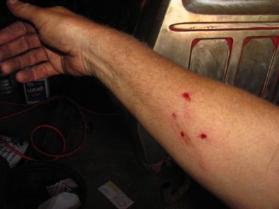

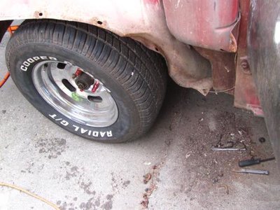

Fender #2 is off. The cut off wheels that I'd bought were from Campbell Hausfeld. One of them exploded on me while I was cutting off the bolts. - First time I've ever had that happen. About a half dozen shards cut into my arm and caused some small bruises. I won't be a whiny cry baby about it but I suppose if I wasn't such a cheapskate and had bought better discs I wouldn't be enjoying that burning sensation in my arm pit now.
You can't say us Mopar fanatics don't put our blood, sweat, and tears into these projects. - Still a lot of clean up work to go.
I know that it seems I take a lot of breaks when I post. Although I've got a decent compressor (a 5 horse Quincy), the tank gets warm after a while so I try to give it a rest. Plus I do have the attention span of a gnat.

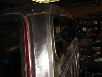

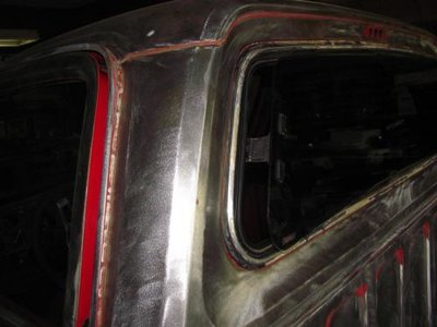

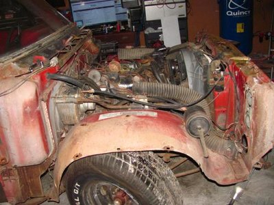

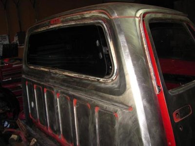

After removing the right fender I took the DA to the inner fender and knocked off as much corrosion as I could. Now I'm re-sanding the rest of the cab. The rain we'd had sort of took the shine off of all those raw body panels. I don't think that the patina is what the painter wanted to see.
A complete restoration of this truck should have entailed sand blasting everything. But this will be my tow vehicle and be driven year round so I'll stop shy of tearing it down much further. Originally I wasn't going to have the jams re-shot but I noticed rust showing on the inner door structure so...

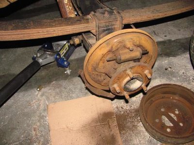

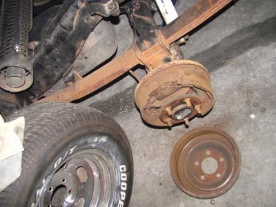

I had to order parts for the rear brakes today. - They didn't have them in stock. One of my adjusters wouldn't spin anymore due to rust. My shoes and cylinders look OK but I most of the hardware was still original, 35 years old, and rusty.

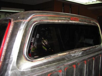

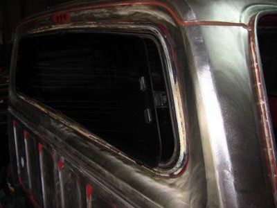

One of the neat features that I have on this truck is the back window. It's made out of a tempered glass that flexes (no, it's not plastic). I don't think they make these anymore. It was made by a company called Le Van and called a FLEX-THRU window. I've seen a few pictures of these installed on mini trucks before. But the thing that makes it really cool to have on a 'Lil Red Express is that the exhaust exits pretty close to them so when you really want to hear that 360, it can go from quiet to loud inside real quick.

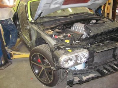

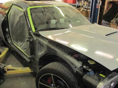

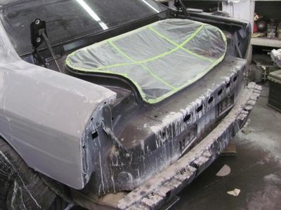

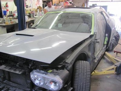

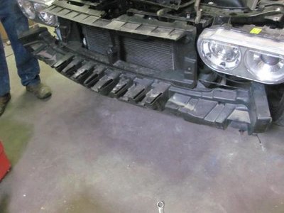

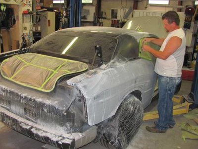

I did manage to snap a few photos of the progress being made on the Challenger though. There were a lot of structural pieces that had damage beneath the replacement parts that had been installed.
I finished the rear drum brakes but I will still need to have the drums turned when I get the truck back. I then turned my attention to the front discs. My right caliper is hanging up. I wish I had checked it sooner. In the morning I'll have to check at the parts store but I'm not expecting them to have any replacements in stock. Larry (my paint guy) is not going to be happy. I wish I had more time but I may have to take it to him as is.
