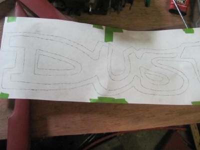

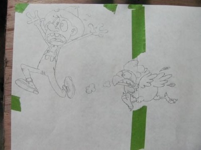

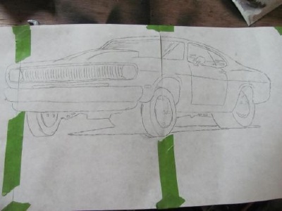

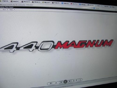

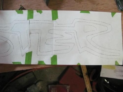

Now I'm starting to do some layout work for the Duster and the dually. - Not for decals but more likely for airbrush/lettering purposes. I'm more or less making templates.
I had been trying to come up with a name for the drag car and it came down to a choice between CROP DUSTER and RAT POISON. I'm working on the CROP DUSTER design now.
I wanted a cartoon image of a Duster on the side of the car chasing a farmer and a chicken, followed by the name CROP DUSTER. The Plymouth logo will be for the rear quarters and the 440 MAGNUM will get painted on the sides of the cowl hood scoop. (if I follow through with this design) I'd like to leave most of the car black and choose a contrasting color to do 'billboards' on the sides. I think I'll do the DUSTER logo in metalflake orange vinyl. The lettering and images should fit nicely with a 6" to 8" height. The hood lettering will be around 2" tall. I am using a 42" tv as a computer monitor and it really helps in laying things out.

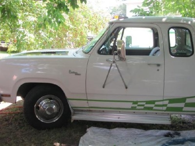

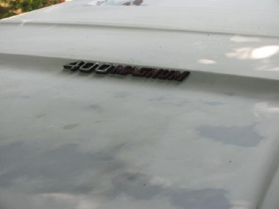

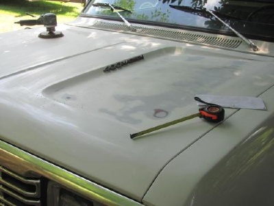

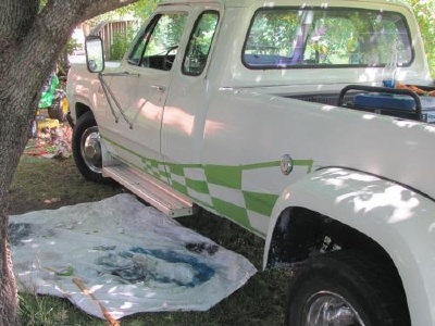

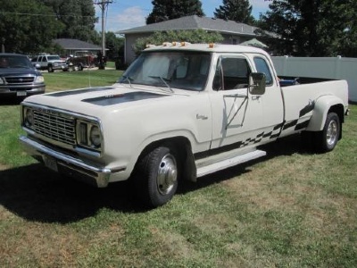

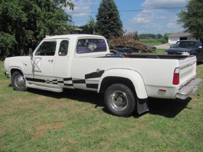

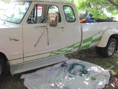

I mapped out the side stripe on the driver's side of the dually today. I need to pick up some fine line tape before I can spray it. It's drawn on the truck in pencil and ready to be masked. I took the time to sand the hood indentations when I drilled the holes for the 400 MAGNUM emblems. - As with the side, I need fine line tape before I can spray the black. I am going to ignore the rust spot in the fender for now. I should fix it but not right now. With any luck I'll have the hood and side stripes painted tomorrow.

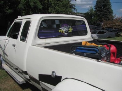

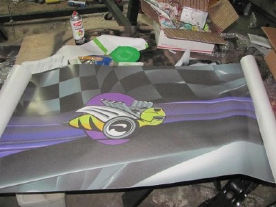

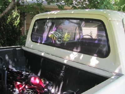

I ran to Columbus today to get some supplies. I picked up primer, paint, pin-striping tape, and lace. Nobody had fine line tape so I'll try to get by with other. When I got home I saw that the rear window graphic had shown up. I hadn't expected to see it arrive for a few more days. I also picked up a new 7 pin wire connector for the trailer light wiring coupler. I didn't get the brake controller yet. I still hope to get done painting the truck tomorrow.

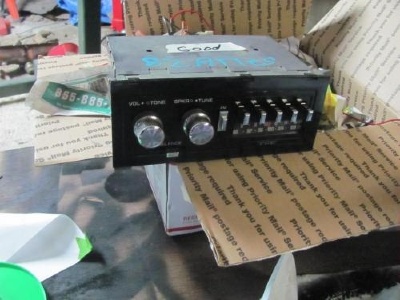

I had also bought a used AM/FM radio off eBay that I'll try to get installed by Friday. It showed up too. Supposedly it's already been tested and confirmed to be good. I hope so, - I don't need another core on the shelf.

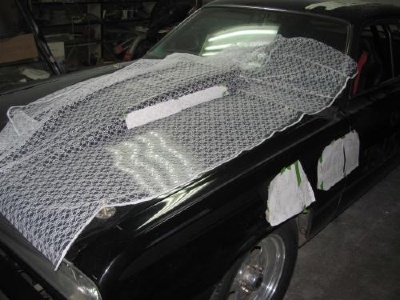

I look at the Duster as being sort of a blank canvas. It's showing it's age with some bubbling beneath the paint along the bottom of the car. Because it's paint is far from perfect I figure I can play with graphics on it. I'd like to experiment with some laced stripes over the hood and deck lid. - Maybe even some scallops and flames incorporated into stripes. I'd done some wild paint jobs on other people's race cars years ago but I didn't have a computer back then to help with layout.

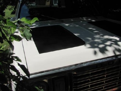

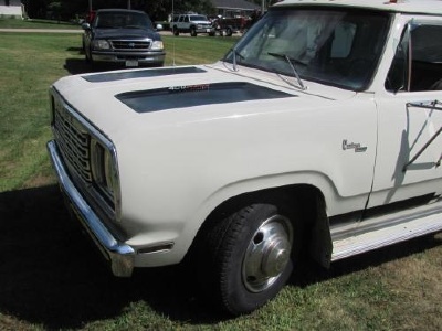

I started the day working on the hood blackouts. By themselves, I didn't care for them. Putting the 400 MAGNUM emblems on helped to make them look better though. I think that the side graphics will help even more. As soon as I'm done masking, I'll shoot them black too. I didn't get the other side drawn out yet. I'm waiting until I see how the driver's side looks first.

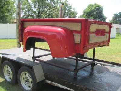

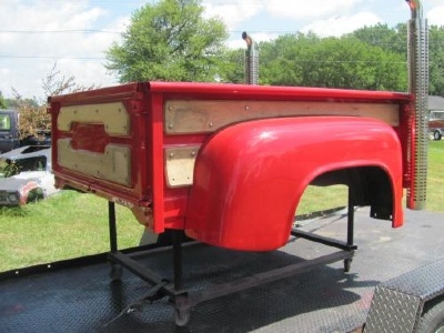

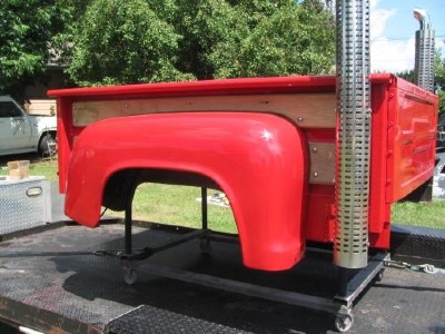

I haven't stained the wood for the 'Lil Red yet. I'd had it sitting in the back of the box and it'd been rained on the other night. - Big mistake! Because it wasn't bolted down or sealed, it warped on me. I went to attach it and found that I'll have to get it to lay flat before I can work with it. The reason that I didn't seal it right away was because I waited for new bolts to arrive. I wanted to make certain all of the bolt holes lined up properly. I hate working with wood. I was totally without a clue that the wood was in danger of warping.

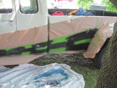

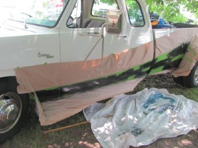

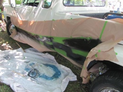

OK. I can hear some of the heads shaking from here. Shade tree engineering. After the paint sets for awhile, I'll pull the tape and decide if it's worth my effort to do the other side. Surprisingly, I've had less issues with bugs in the paint out here than I did inside the garage. With my luck there's probably some evil flock of sparrows just waiting to add to the artwork.

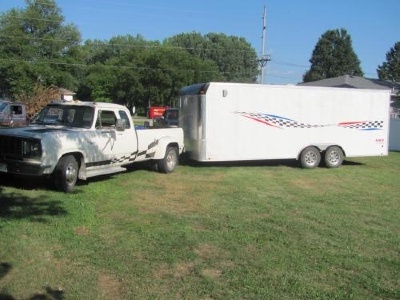

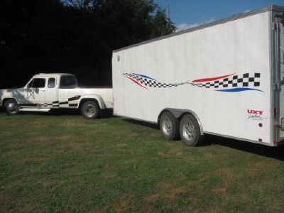

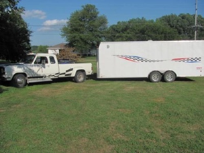

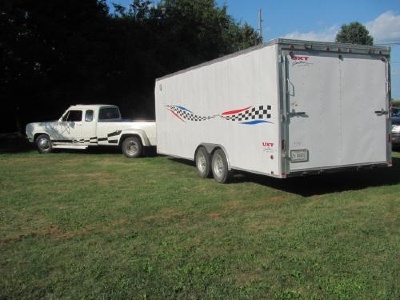

I picked up the enclosed trailer that I'll be using next weekend when I go racing. I hadn't realized that it was going to have a checkered flag theme on the side of it too. Cool!
I'll have to wire up the trailer connector before next weekend and test everything out.

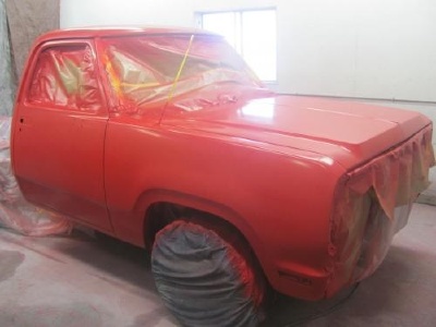

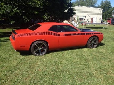

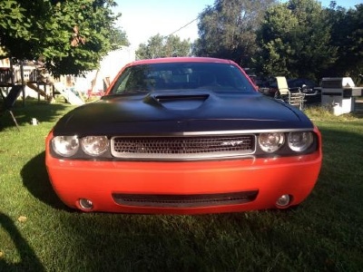

The stripe is on the Challenger but it still needs a lot of the trim installed. I'd forgotten to order a new windshield for the 'Lil Red so it will be a few more days before one arrives.

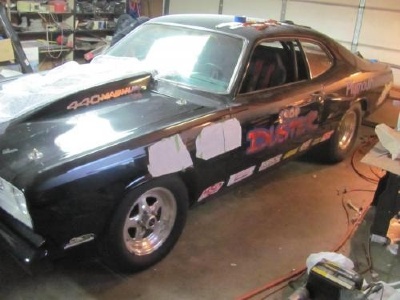

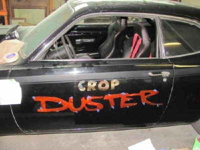

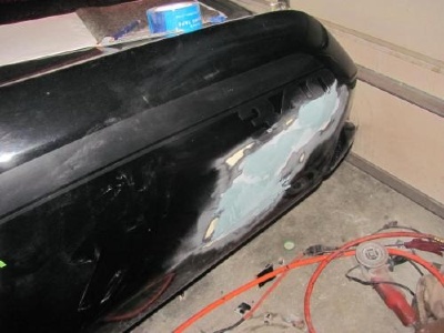

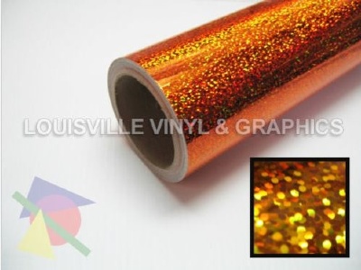

Well the garage is clean enough to squeeze the Duster in. I had some cracked bondo showing in the left rear quarter and decided to fix it before paint. - Keep in mind this is a race car and not a show car.

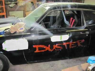

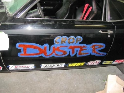

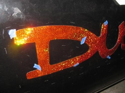

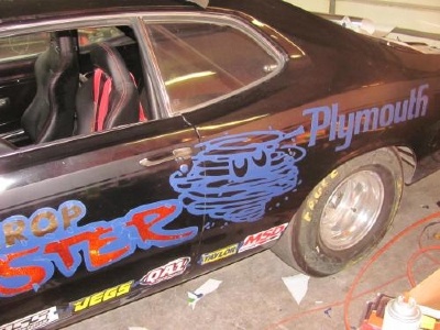

I'm still playing around with the layout. The roll of orange metal flake vinyl came in the mail today so I started cutting out the lettering. I haven't decided whether or not I'm going to put the PLYMOUTH on the rear quarters in black or in more of the metal flake. I did decide to cut the word 'CROP' out of chrome vinyl though.
I'm going to try to apply all of the vinyl before I shoot the gold paint on the sides. My plan is to leave a heavy black border around the lettering, so I'll mask over the vinyl (leaving a border) and spray the gold over it all.

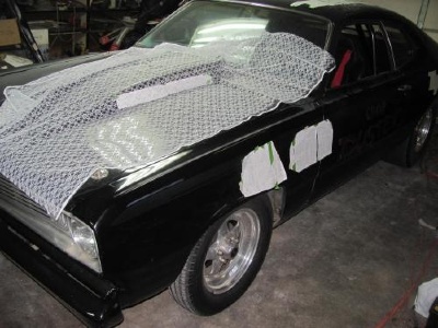

I was going to play with some lace hood stripes, but I better keep concentrating on the rest of the lettering & paint first.

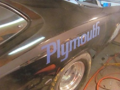

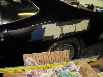

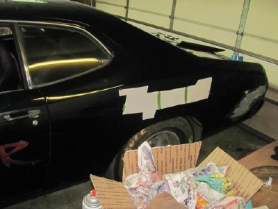

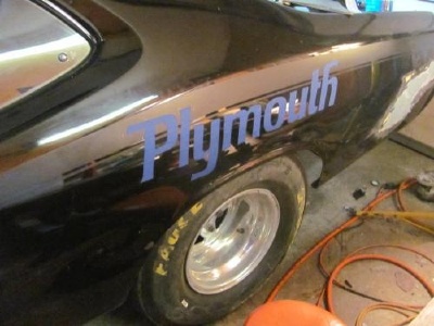

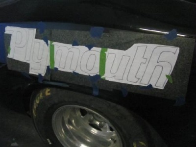

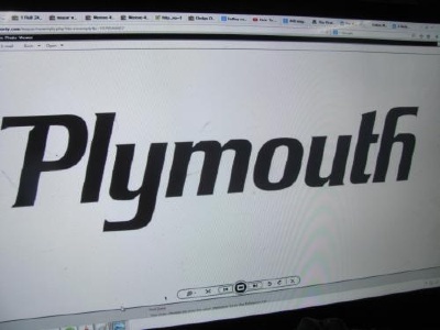

I decided to make the PLYMOUTH black on the quarters. After creating a template the size I wanted, I positioned it on the car. I moved it around until I was happy with the location. The next step I took was to lay down some masking tape under where it would be. Then I took a few sheets of carbon paper and taped them over the masking and put my template over that. After tracing the insignia, I had the lettering transferred where I wanted it and used a razor blade to trim off the excess. Now all I need to do is spray my gold paint over it and peel the mask back off and I'll have my black lettering.

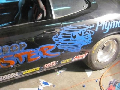

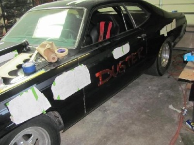

The sides are getting closer to being ready for the gold paint. I have the shadow masked off behind the CROP DUSTER logo now. I taped some contingency decals in place while I was at it. My FABO decal is on the front fender.
