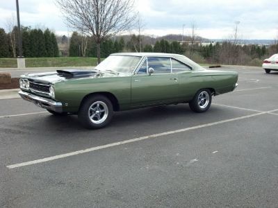

You'll notice I have a 6bbl hood on mine, which is definitely not correct. Many other things aren't correct either for the car, including the 4 speed transmission. Im a believer in building your car the way you want it. That said, I really don't think I'd ever go to the extreme of changing a whole appearance to a different model year. Id think it would be easier, and cheaper, to start off with a solid 69 RR if that's what you really want.
