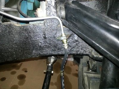

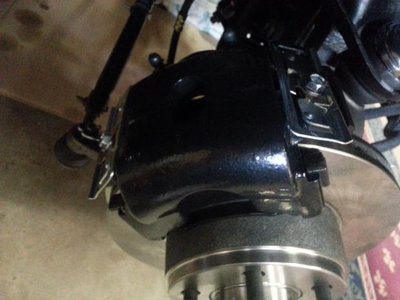

Although I did not plan on wrenching on the Road Runner this weekend, I could not keep away from the car. My In Line Tube order arrived today, and I had to at least try to finish off the passenger side.
Routed and contorted and contorted some more the brake line that runs across the firewall to the passenger caliper. Went easier than I thought (finally something to do on this car that does not take hours and hours).
Ran into a small delay getting the rubber hose to seat into the clip mount at the frame. When I took the drums off, there was no clip on this side for the rubber hose. Didn't give it much thought at the time. Now I know why there was no clip. The mount tab at the frame was slightly bent such that the hose would not seat into the mount. I took a LARGE vise grip and just kept clamping the tab to get it as flat and planar as possible. This worked to an extent as the hose would seat, but a slight wave in the tab made placing the clip on the hose slot impossible. Took a small solder assembly bench vise and clamped/squeezed/pressed some more. Finally got the clip on.
Followed In Line Tubes instructions on seating the line nut to the hose.
The passenger side disc conversion is now complete!
Have other commitments this weekend and my other vehicle needs some maintenance (Grand Marquise), so no more MOPAR wrenching for me until next weekend (unless I find a few minutes here and there to bench bleed the master cylinder).
Wish me luck. Next step is complete the drivers side conversion. Then porpotioning block mounting and master cylinder install. Last step is replace lines to the rear, and install new Raybestos wheel cylinders.
Thanks for listening! Have a great weekend.

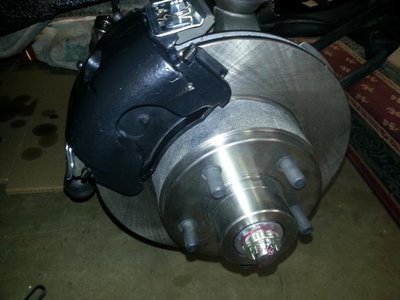

I'm heading out to the garage now. My plan for today is to get the driver's side rotor and caliper mounted. Should go easy, but I have said that before.
QUESTION: I've got the car's front on jackstands. I only have two jackstands. Should I (one of the following)
1) Buy two more jackstands (at O'Rielly). Carefully jack up the rear and have the car on all four jackstands.
2) Get the front tires on and on the ground. Chock the front wheels. Get the rear on jackstands.
3) Have the car flatbedded to the local brake shop and and let them finish the job. This option has occurred to me quite often.
I have rear wheel cylinders. Next step would be to remove and install the rear hard lines and wheel cylinders.
Thanks for any advice. Take care, Bill
