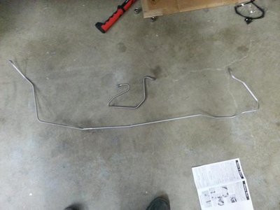

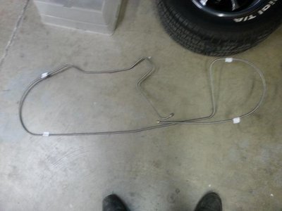

Well I'm done for many days. It seems InLine Tube sent me the incorrect lines for the rear. If you look at the pictures, these are my last three remaining lines. The big line looks like it goes from front to back, okay, but the last two lines will not connect from the rear wheel cylinders to the Tee.
I called InLine Tube, and read one of the part numbers, and he said "...yes, that looks like a front line...". Then I was really bummed when he said eBay orders support are email only, and they won't answer your email 'until Tuesday'.
FRUSTRATED!

InLine Tube did reply, and I have to say I'm happy (although I probably won't have the lines for next weekend). Reply below:
"Bill, the long line is the front to rear line for the car. The other 2 lines are a second set of right and left front lines and not rear axle lines. We apologize and will have the pair of lines out by tomorrow for you. Thank you!"
