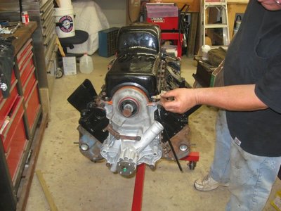

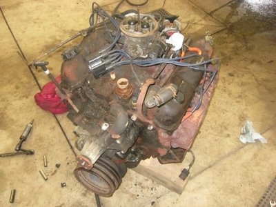

New(ish) 318
The motor is now in, bolted up to the tranny, etc... Found out last night though that the pass side engine mount had to be changed. The '78 and '88 ones were a tad different in size. I ended up using both of the '78 ones. It would've been nice to know BEFORE I used POR-15 on everything!
Tonight, plumbing will be worked on, along with the top end electrical stuff. I hope to have her fired up sometime tonight (doubtful) or tomorrow.
