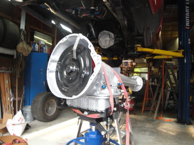

TRANS UPDATE.....JUST PICK HER UP.....GOING IN TONITE/TOMORROW.......800 IN PARTS FROM A&A RACING TRANS AND 500 FOR MY BUDDY TO PUT HER BACK TOGETHER.....HE WAS IMPRESS WITH THE HEAVY DUTY BUILD FROM JOHN COPE RACING[attachment=0:3tofok21]DSC02411.JPG[/attachment:3tofok21]

4spd69RR said:
What was the cause of the failure after the burn out?
PUMP GEAR WHICH WASNT HARDENED 4340 STEEL SNAPPED BOTH TEETH RIGHT OFF....BOLT IN SPRAG CAME APART.....HE WENT WITH A HEAVIER BAND AND CLUTCHES....NEW ROLLERS....ETC
HE WENT THRU EVERYTHING....LASTED 5 YEARS
THIS IS THE TRANS:...The most complete foot brake torque flight anywhere. 22X Reverse manual valve body with low band apply, Bolt in sprag, Alto Red Eagle racing clutches, Kolene steels, Thicker band strut, Red lined bands, Teflon rings, Rear billet servo, neutral switch, 2 cooler line case fitting, 4.2 billet 2nd gear lever, Mopar reusable pan gasket, deep aluminum pan & billet filter extension, Modified pump support, 4 or 5 pinon steel spline planetary with bearings, 3 or 4 rear planet with bearings, rear roller support, Your choice of a billet steel or aluminum front drum, No kick-down linkage needed.
