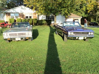

if you go to cars on line or ebay there is a lot of deals out there--stock market is doing good so cars and gold are down. get some inside storage too kept it niceAL PIC  LITTLE 150.jpg

Beautiful cars mahoney.. thanks for sharing.. should the engine and trans be matching to the frame as the main matching numbers. I am looking for a basic 383 69 roadrunner in excellent shape and would like to stay under $35K, with matching numbers. Again, which all numbers should match to making it matching numbers. I really appreciate the help and thoughts. Love those ragtops man!!! Stan
