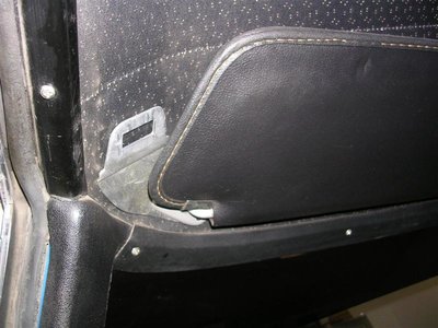

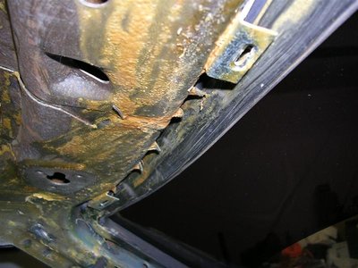

22,145
Its painted metal that snaps into place with clips and one screw at the front. There are clips under the windshield that the front metal screws to and they are a hell of allot easier to put in before the glass is in.
