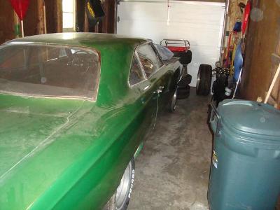

greeeeeeeennnnn.... :drool: :drool:
on here we pretty much agree that it's your car, your money, do what makes you happy. that being said....I vote for the 440. A new Hemi in a musclecar mopar is about as thrilling to me as one with the 24" Donk wheels.

yeah but thats the good shade of green 999 ralley green :drool: :drool: :drool: :acme: :acme: :acme: :acme:

Thanks for the advice guys. I've been leaning towards the 440. Now I can sell the 6.1 and get some more funds for the rebuild. Anybody have a clue what a good asking price for the Hemi would be? 15k miles with the nag 1 tranny.
