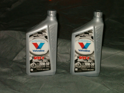

I was using Valvoline VR 1 until I found I could get the Brad Penn oils cheaper than VR 1 buying it at local race shops. In my opinion there is non better than Brad Penn which is the former Kendall brand. Brad Penn oils are very popular at the local drag strips and dirt tracks in my area but are not limited to race engines.
