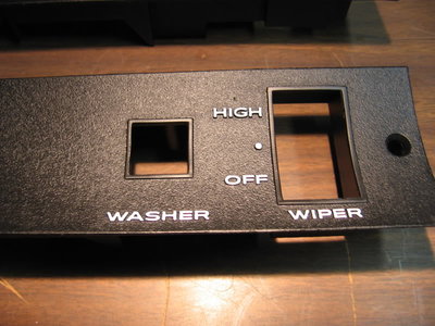

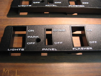

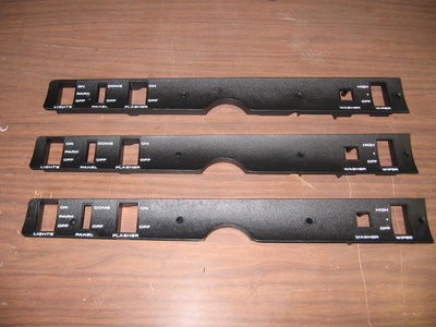

I used an eraser dipped in white paint and just dabbed. I would like to know how you restore the black textured surface???
22,145
2,356
Here is one I have restored that I am going to put on the b-body site tomorrow for sale. I got my pen at Joanns oops I better get better pics the lint looks like a scratch :lol:
