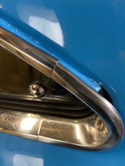

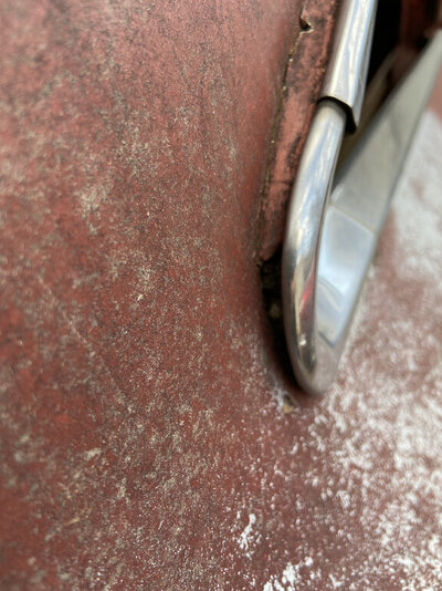

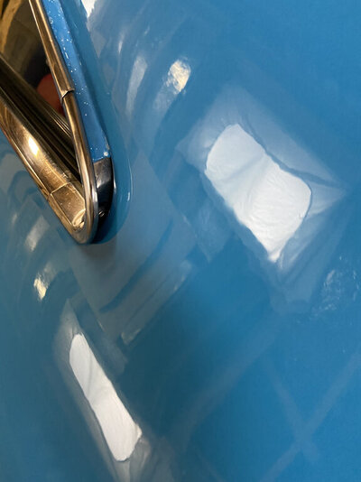

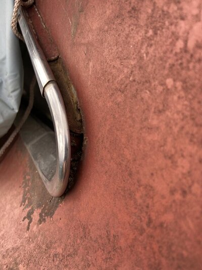

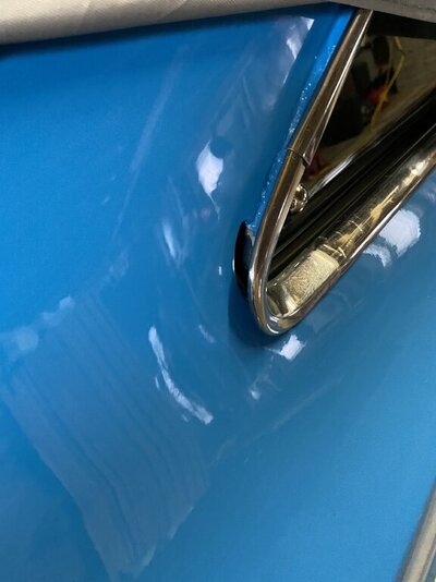

I have a 68 coronet also. There is a void in the curve of the chrome on theses cars. I think they didn’t worry too much about it sense it drains to the bottom of the 1/4. I will get you some pictures of both. I thought about seam sealer and paint it with the car but decided not to worry about it.

Don't have that gap on my 69. But did have a gap where the tear drop went on the end of the drip rail inside towards the window frame. Would fill that with some urethane window calk. That is what rust these car's out letting all that water run into your rocker panels. Just my two cents. I saw what rusted out these car's when taking it apart and addressed those areas. Better to have it run off the car than into the car. LOL. Hey, keep up the grate work and wishing you the best on the restore. :thumbsup:

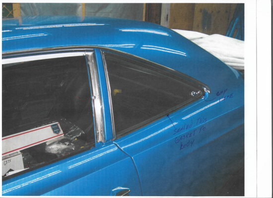

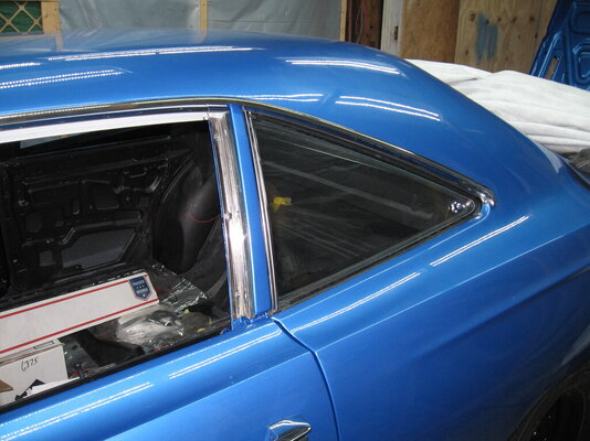

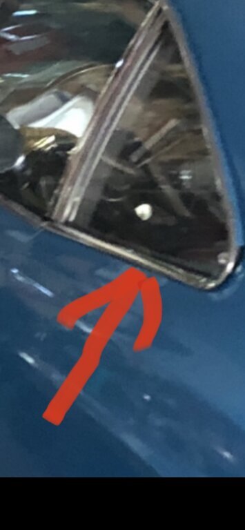

Scan_20220223.pngDid Not have a red pen so hope you can see my chicken scratching. Sealed after painting the car. Used yellow tape on the body to make a good line and on the gasket. When you get it they will send some long pieces of foam with it that stuffs from the inside. This makes it fill out to the body. Or your trim. The post gets foam type gasket material behind the window frame and the top of frame also. I used too much on the top and took some out so it would fit better. Trial and error. Also used 3M sealer on those don't think the factor did. Take plenty of pics when taking things apart. Which we all don't do as well as we should when removing parts off the car. Years later we forget what or how it went. I am guilty also. Keep at it and you will get it done.

I installed the passanger side pop-out yesterday. There are gaps mostly at the bottom to the body but also my window sits lower than the trim. Gaskets and sealer! I'll get the other side in today and re-evaluate.

After installing both sides, they fit OK but I don't think the pop-0uts were made to fit the trim package I have. They seem to fit where the rubber lip would go over the body but the trim sits above. I think I said before, I would do without these trim pieces except, there are six holes in the doors for trim to match and car is already painted. Ideas?

There is black and white foam strips that are the gasket material for top of window frame and to pillar post. Had double layer at top as came out of car. Aftermarket must be thicker so took mine out and used one layer. Window was wanting to hit the body when opening it. Trial and error is the only way to adjust it the way it goes. The bottom gasket does not go over the outer body or trim it will be stuffed with the foam strip's you should have in the window gasket set will expand the gasket out to the body. This done from inside the car. Push those strips into the bottom side of gasket till it expands out to the body or your trim. It will have curved appearance. Mine kept wanting to pop us so had to try -try again till it was just right. LOL. If you put your pics in your computer, click on attach files. Go to pics the find the pix you want click on it then hit open it should download to your forum. Then you can choose full image or thumb nail. Hit the selection it should load for you. Keep us informed on the progress. :thumbsup:
