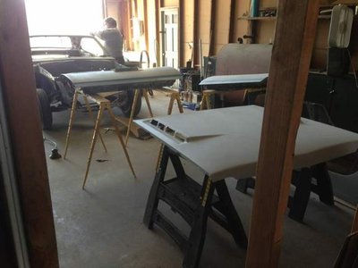

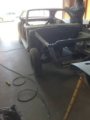

Hey fellas,
Been very busy on the RR blocking the high build primer. Looking to shoot the T7 in the jambs, trunk engine bay the week of April 15. What color primer is needed before I do this? I have seen black used before plum crazy, and I noticed black primer under the factory paint. I have heard to use red oxide from others? Not sure on this...will be using PPG paints. [attachment=1:3vmd87d1]ImageUploadedByTapatalk1365370076.193538.jpg[/attachment:3vmd87d1][attachment=0:3vmd87d1]ImageUploadedByTapatalk1365370083.326795.jpg[/attachment:3vmd87d1]

Just finished spraying the final high build primer today. Finally down to wet sanding the trunk, jambs, engine bay and window channels...seam sealing then paint.
