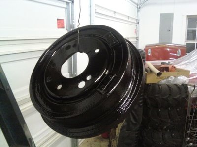

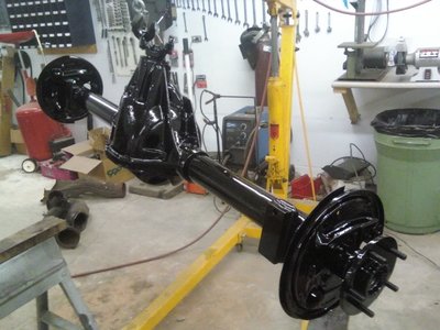

Here's what I did last night.
Rear Brake hubs, springs, and rear end. The other rear end picture has epoxy primer only on it. I used my descaler to strip it down which really worked great. You guys will have to have one for getting into the nooks and crannys.

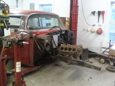

Dang, I wish I had a big garage like I see so many of y'all with. I've got a 1.5 car garage crammed with 2 vehicles and car parts everywhere. Absolutely no space to be comfortable while working or organize anything.
Don't feel bad. This is what I have to work with. I finally found out that the only way I could fully open one of the cars doors was to park them this way. Otherwise I would have to back one of them out of the garage to work on the other.
