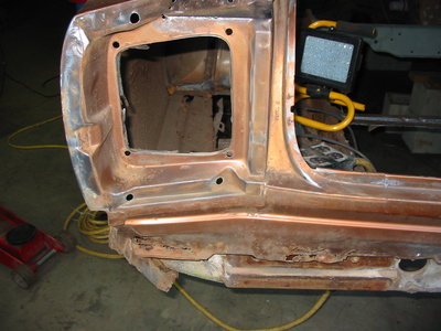

I am going to be installing some new quarter panel on my 68 roadrunner and I am uncertain as to whether or not I weld the gold marked areas on the trunk extension and tail panel to the quarter panel.

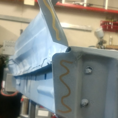

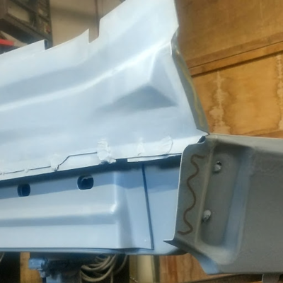

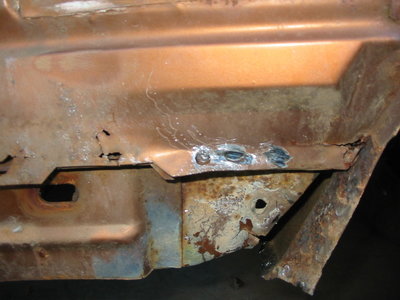

Hello, this winter I went through that process, had to replace the whole metal sheet at the back of the car. As far as I can remember, I welded both of your gold marks on my quarters.
The upper piece (forgot the English name sorry) was it original or you also replaced it?
because I had to replace it, but first I installed my quarters then went for that part and had to adjusted it on the extremity with the quarter.
Then I welded it just like you on the trunk floor and then with clamps welded it on the quarters.
I will check tonight once I will be home but if you want you can go on my post in the project section. You will find it page 5, but the pics aren't big enough but we can see the welding marks.
