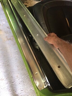

OK, so today just a little light stuff, replaced the doors sills here's a picture. In a couple weeks the seats will be reupholstered so that will be cool. I would like to raise the passenger seat cause me wife sits low. Anyone ever shim one of these up an inch or two?
