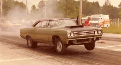

I agree about the 8 3/4.
My car from the 70's. 10 1/2" slicks with a 440 and 8 3/4 rear. Always launched like that (although it was a lot faster than the dial in shown)... never broke a rear.

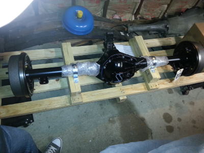

I bought my Strange S60 (Dana) from Summit. You can buy them directly from Strange, but I had a 10% off coupon code with Summit and it saved me almost $300 going that way.
I spent about $2700 for mine, complete with powder coating, snubber, upgraded diff cover, and 11 inch drum brake set-up, delivered.
Like Harold mentioned, the cost isn't bad when you factor what you're getting compared to a used Dana or rebuilding a 8 3/4 with all new items. Plus you can sell the 8 3/4 and put that toward the cost!
I won't know how it works for about a year...but it looks sweet!
Stuie it looks like you have competition as a foot model. Chapdog wears Keds and looks like a pretty good size foot :jester:
