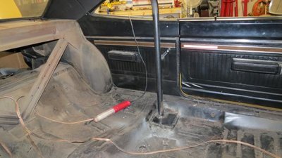

front of the back seat sits in two clips that you need to push back and up to clear, the back of the seat has a couple bolts at the bottom and then push it up to clear the two drop into brackets at the top. as previously mentioned that leaves two small clips to remove and out it slides.
just to give you an idea what is behind the seat

for carpet just lift up the front of the rear seat and slide it under, for the shelf the whole seat must come out. the front bracket is right next to the drop light in my picture. one on each side
