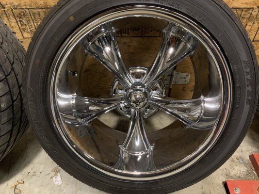

Should not be an issue on the rear, but might have problems on the front depending on tire size. Interested in something like this?

The ones I found were the Mopar Rallye Rims. I'm wanting to get back to the original look. The tires I found were 245/45-17. What would be the possible issue with the fronts?
