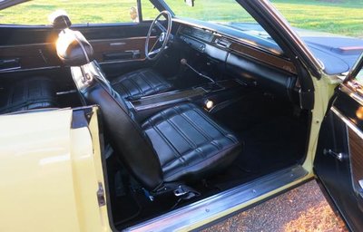

GTX got you fancier interior, woodgrain dash I do believe. more chrome trim on the outside, rockers, wheel moldings.And you got the 440 4 barrel if you wanted, road runner was 383 or Hemi, except for the '69 1/2 440 6 barrel and the 440 6 barrel for '70.after '70 the GTX was moved to largely a tag onto the road runner.
