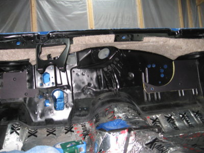

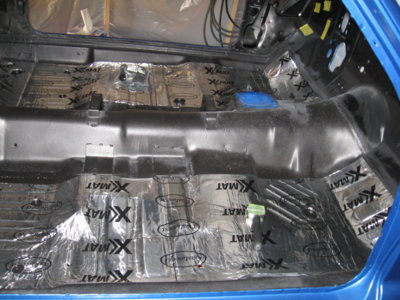

You did not see the X mat I installed in the car. Got it from East Wood. Heat and sound deadener. Also put it on the roof instead of the original insulation. IMG_0102 (5).JPG IMG_0103 (2).JPG

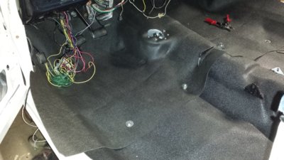

Here is a picture what NOT to do.
Look around on the net for pictures and see that the carpet normally come ups and covers behind the gas peddle.
If you stand on the passengers side you should not be able to see the firewall under the dash like in this picture.
It was my bad.
I cut too much and ACC was nice enough to sell me another front section at 50 percent off for a redo.
Don't think I have any pictures of that, but best idea is to slit the vinyl and get it behind the peddle and then nibble it off where you need to so it covers the firewall.
Tin snips work good.
Note that I've got it in place with bolts while I worked on it.
And the 4 speed hole too.
Work from the center areas out.
As far as the door sill plates, it's hard to give any rules, but make it come up and over and captured under the plate like the carpet would be.
You probably will need a heat gun to form it better up and over and the "lip" at the top.
That way no water should get under it.
Remember these cars are not like new cars and sealed up good around the windows.
Garden hose pressure when washing on the side washing it will cause some leakage.
Best to spray and not hard stream the water around the side glass
Again if you are careful you can seal the peddle base to the flooring with PL30 and it will never get water under it from a spill or leak.
Tape that for a neat joint when applying the sealant.
