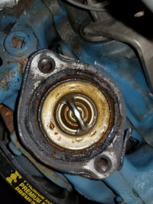

I had the same problem going on for my 68RR. So I drained it down and flushed out the radiator. He was pretty dirty in there. Pulled and ordered both upper and lower hoses since I have the system down. And pulled the thermostat housing and found it pretty nasty and sticking. Ordered a fan shroud for it from classic industries. Fixing to put it all back together tomorrow. Here is a pic once I pulled the thermostat housing.

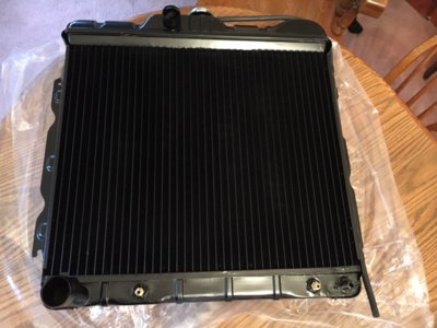

Same issue, 383 runs a little warm. New radiator, hoses and stat. Fan shroud is the remedy? Pulled the stat out today to check if that will work a little better.
