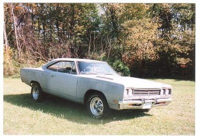

look at this beautiful she beast !
got any more?:thumbsup: I seriously think primer is a good idea. No worries about scratches/chips/dirt. Keep a fizzy can in the trunk and instant touch up, no worries on the color match. My buddy apoligies everytime I go over to see the car abouth how long it's taking, and has offered several times to throw some primer on it so I can drive it some. But if I'd do that the car would bever get done.

From the looks of the car in your pics, I shoulda just sent my car to Vermont for restoration.

From your pictures I can see you are very talented and doing just fine . It looks like you do your own body work . Didn't you replace the quarter panels and do all the bondo work yourself ? Replacing quarter panels is something I would never attempt , its way over my head. But thanks for the complement .
