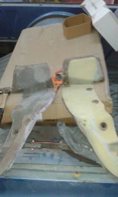

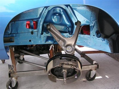

I went and got pics I just finished cleaning it up for Vegas. I might have some of these that I bought in the past, I don't know if they are reproduced other that the inner fender. If I thought it was hard to find I bought extras, you know us hoarders :lol:
What is the name of the shield in the middle pic?
Don't know, pretty common they are on the inner fender

SomeCarGuy said:
That is what covers the ball stud area for the Z bar pivot.
I like that name, kinda long but what would you call the one on the other side :lol:

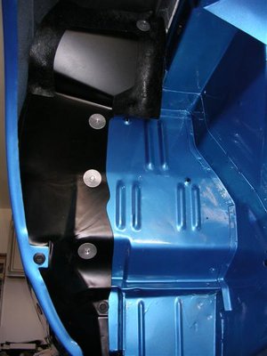

What about the large metal inner fender splash shields? Are these supposed to be body color or black?
Here is mine and I probably didn't get as messy near the upper control arm as I should have with the under coat. Got the pics out of order the bottom one is prior to sound deadener of coarse

Is anybody repoping the covers in Bob's 3rd picture?
Also what are they called?
Tried to find the P/N in the parts book but can't find anything on them unles I'm alookin in the wrong area?
