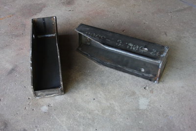

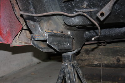

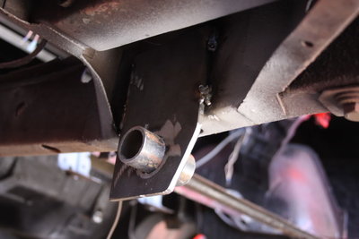

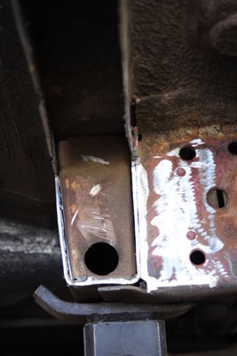

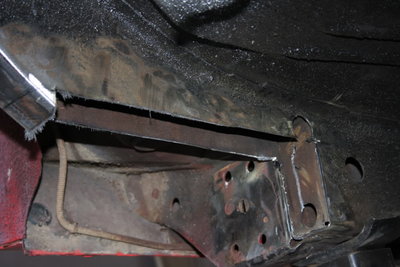

Well I finally got up enough guts to do this. I narrowed 3-1/2" per side. I squared up everything on the from the front torsion bar frame which worked great. I made my own hangers and only wanted the hole. I used 12" 3.5" x 3.5" and marked it out on the frame. You can see a little notch at the front. Tomorrow I will set up the shackle perches. I measured the stock spring width at the original hanger and at the shackle perches and they are both 44" on center, so they are parallel. I dumped the photos on photo bucket so we'll see how this works posting them.
BBillyC
Mar 2, 2009
460
3
Winnipeg, Canada

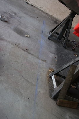

In lining this up I dropped a plumb bob from the torsion bar frame on both sides and marked the floor and snapped a line. Then marked center of the original hanger holes onto the frame and dropped a plumb bob from the center of the hole on both sides and marked the floor and snapped a line. They were an exact measurement showing that the spring holes in the hanger were perfectly square. I used the same lines to position the hole in the new narrowed hanger. Then I measure in from the center of the old perch 1-3/4" to set the outside flange of the new hanger. That makes the whole thing narrowed by 7 inches in total which left about a half in on either side of the frame for welding. I must admit I was quite surprised at how flimsy the stamped frame metal is. I had to use enough heat on the welder to penetrate the heavy gauge hanger and yet weld the thin metal without undercutting it. I umped around from spot to spot so as not to put too much heat into it. It may not be that pretty but it worked out real well. Tomorrow I am going to design the new shackle perches and put them in.....then it is on to finish the mini-tub and the trunk floor. Hope you liked the photo's. Bill :cheers:

i think its pretty....the welds look like you know what your doing and did you make those.....they are alot heavier then mine....great job....looking good :thumbsup: :thumbsup: :thumbsup:

I made them from 3.5" x 3.5" with 3?16 wall seamless square tubing. I have to make stuff because most parts ordered in from the states cost too much once you factor in brokerage, custom duties, taxes and shipping. these cost me $0, and my labor was $0 so I saved a bit. I worked as a welder fabricator when I was a kid so metal is not new to me, I must admit though that I am a little out of practice and my tools aren't the best, but it works out in the end.

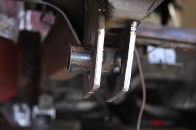

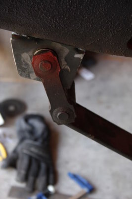

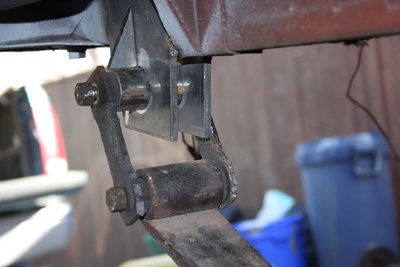

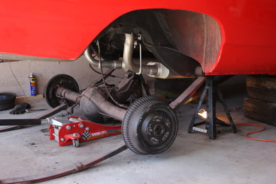

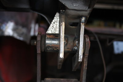

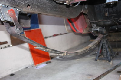

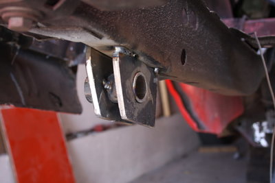

Well the frames aren't parallel and the stock measurements tell me that the spring alignment is, so I had to develop a way to mount the shackles offset a bit. I took Georges idea and embellished upon it. I also tied the old shackle member to the main frame rail to stiffen it. It's all tacked together and mocked up to prove alignment before final welding. I am going to weld it up this morning and begin the mini-tub. The alignment is perfectly square and parallel and from the centering pins (side to side) on the axle it is dead on. Hope you enjoy the attached photos.

very nice :thumbsup: :thumbsup: :thumbsup:[attachment=1:k5qil7t7]DSC00074.JPG[/attachment:k5qil7t7][attachment=0:k5qil7t7]DSC00073.JPG[/attachment:k5qil7t7]

Thanks George. Of course I will need new shackles and bushings. In an hour or so I will get down to welding it all up and then the mini-tubs.

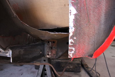

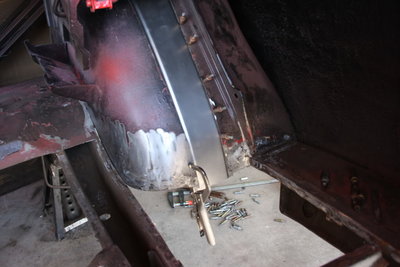

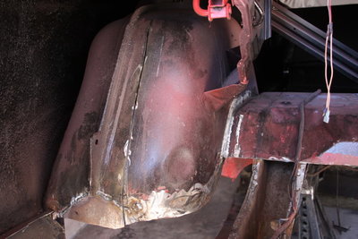

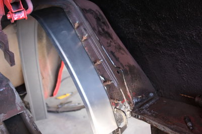

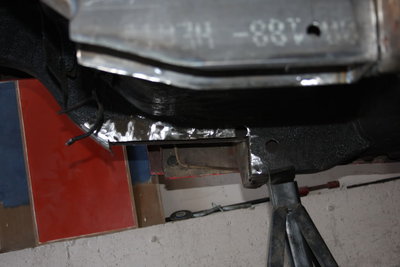

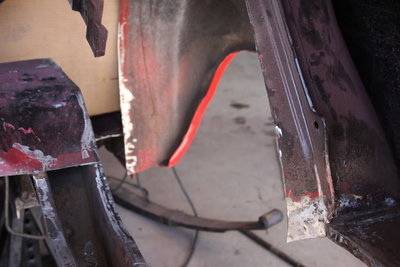

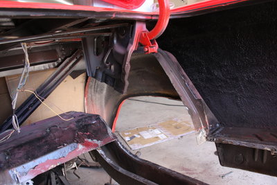

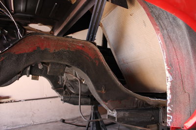

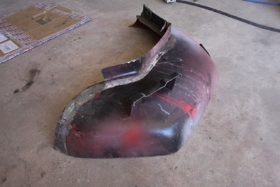

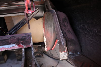

You betcha. Got one side of the tub welded in and the other cut out. Bitch lining it up when you're by yourself. Lots of work :hack: Cleaning up the crap on the cut out well and getting the old piece of trunk floor off was nasty. Tonight when I was welding it up I noticed I was getting low on gas real fast. The plastic line inside the hose got a nick in it and I lost about 3/4s of the tank before I noticed. Spent two hours fixing the stupid thing. Some pics.

some job.....i told you it was going to be fun.....working alone is fun too.....your almost there billy....keep plugin away :thumbsup: :thumbsup: :thumbsup:

Great progress in such a short time. You certainly have my admiration. :thumbsup:
Thank goodness for Clecos...
