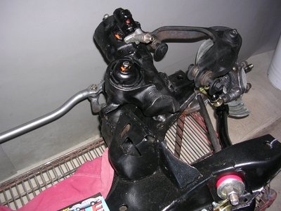

22,148
2,358
Steve I just did one for the Valiant to about 10 minutes. Oh no car attached :lol:
