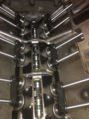

Looks like the valley pan did not seal well and that oil and air were being sucked in. Only about 500 miles on cam so a pic to show the wear. Going to measure the valves

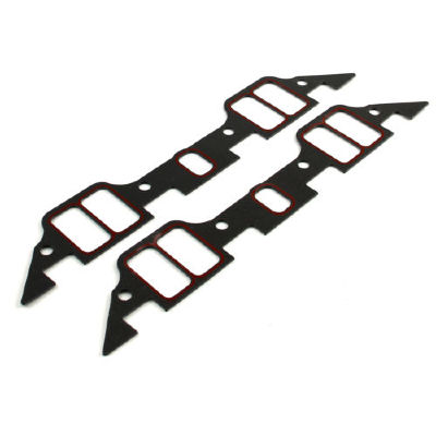

So just as Russ69Runner stated the engine shop does NOT want to mill the intake. They recommend Indian Head Shellac Sealant by Permatex. They stated that with the metal gasket will be perfect
Just gonna toss this out there.... On the aluminum manifold for the A12 in 1969, the factory installed a thin gasket on top of the steel intake gasket. I've used them on aluminum manifolds and had good success in sealing them on the first try. They were available from Fel-Pro, but IIRC, I believe the Mopar gasket (if still available) was about half the thickness.
Some guys use them and swear by them. Some don't feel it's necessary. As I say... Just tossing it out there as food for thought.

I actually tried to use those the last time but due to the work to the heads and intakes the bolts wouldn’t fit
