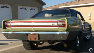

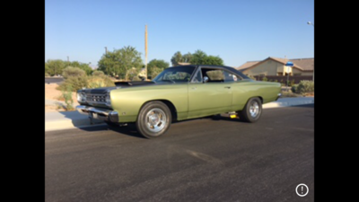

A1DF414B-E2C8-451E-88D0-2346F795973E.png 299BCF11-FC6E-4D39-A5E0-EE294B201122.png I don’t know if they been replaced before I got the car but mine have 5 leaf on both sides and I run N50 15’s with regular shocks, no air shocks, I think its the same platform as the 70 just redesigned quarters

Looks sweet…big fan of your color. As for the height at the rear, it might be somewhat of an elusion because of that very difference in the wheel well openings front and rear. Don’t want to break the bank on raising it 1-2” with new springs,but it could probably use a refresh at some point anyway. Never have been a fan of taking a old muscle car and slamming it down like the newer examples.

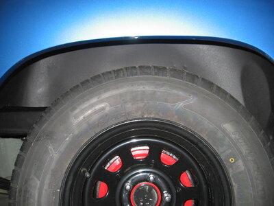

6 leaf both sides. If you buy block's then need new U bolt's. Better off to get new spring 's and be done with it. Here is a picture of my 2 1/2 recurve's I like the stance they give the car. You can get them in 2 inch recurve also. Here is the height on the rear wheel's. Car was not loaded at the time so it has gone down some with the motor and all in the car. IMG_0101.JPG

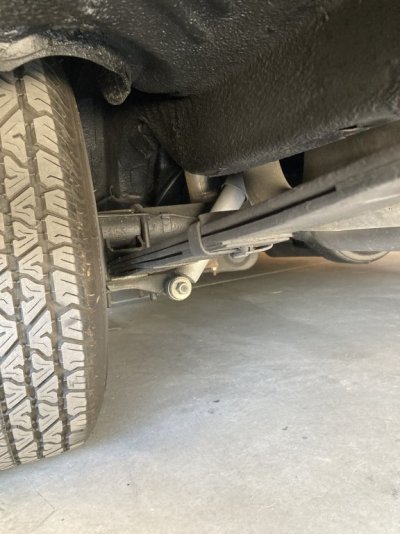

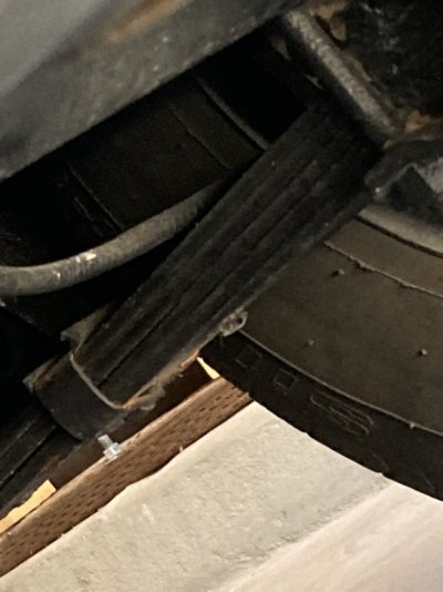

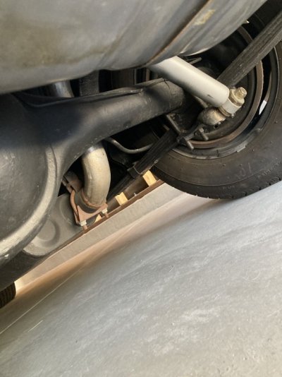

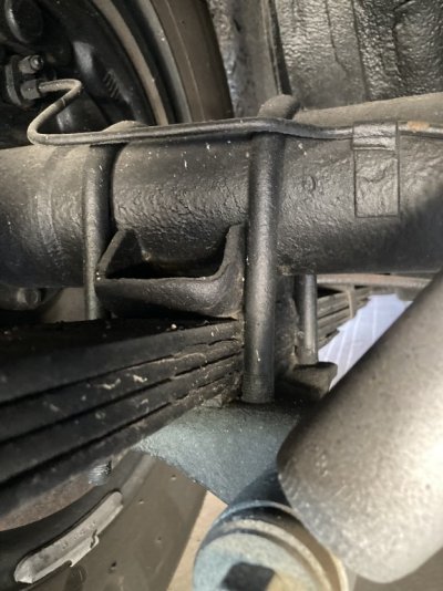

Here’s some shots of the 70 Roadrunner leaf springs l&r and fwd & rear of the axle. Count 4leafs aft of the axle and 5 fwd of the axle. That 5th leaf appears to begin at the axle and show fwd. Someone hear said they are technically 4-1/2 leafs. So would an actual 5 spring be more supportive and slightly higher or is the 6 leaf gonna get the job done. More than likely the car is not going to get street dragged or launched at every stoplight so I don’t think there’s a need for the 6-leaf driver side and 7-leaf psgr side for big torque.
Thoughts???

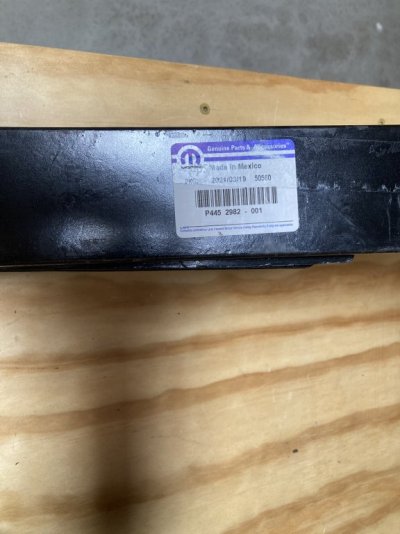

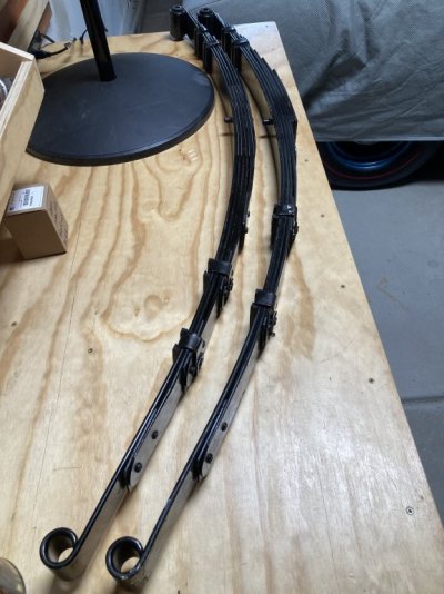

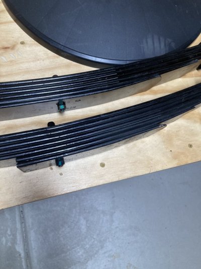

I just recieved the Mopar rear leafs (MIM) they are the leafs with 6 drivers side and 7 psgr. side that torque thing. My question is has anyone else run this combo on their 70RR and what did you think? Pics soon!

Do they have more curve than your old one's???? After getting my car on the road for 25 miles. The six leaf 2 1/2 inch recurve rides good. Not as stiff as I thought it would be. Full tank of gas and it did not crouch any. It rides good. Wish you the best with those new spring's you should be happy after you get to drive it. Those tired old spring's have no spring left in them. Latter woodwiz ----- Russ.
22,281
2,526
Those are hemi springs they work great but they most likely won't raise the rear of the car. They will settle down to the stock ride height.

You guys know more than me,but the ride should be pretty solid after 50 yrs.and if I get an 1” or 2” lift that’s a bonus. It’s interesting how the drivers side 6leaf would not ride lower to the psgr.side 7leaf. Here’s the pre-install pics on the bench,Oh did I say it was 113*degrees in the garage today. I can’t even touch the springs.
