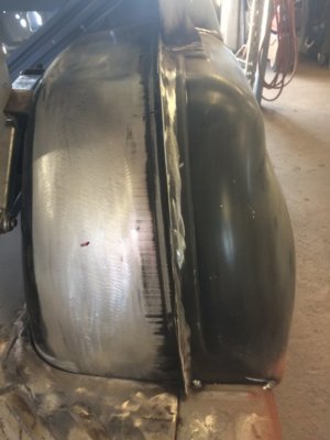

This tub should fit a 15" wide tire but I need to know what the tallest is that will clear the front lip.

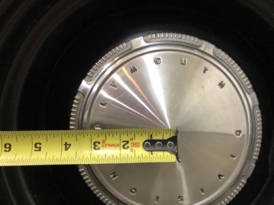

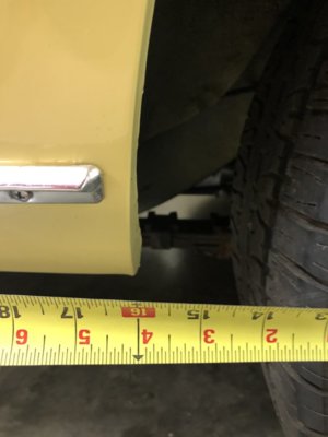

this is a 27” tall tire on a 8” rim. From the Center of the hub cap to the front was almost 16” bang on. So 15.5” x 2 = 31” to be safe is my guess.
