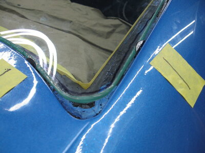

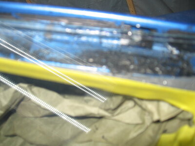

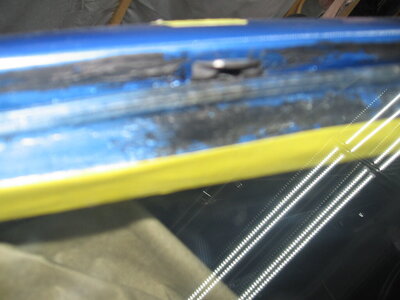

So here is some pic's of the new glass I got. Dose not fit. Too high on the sides and the bottom corners are turned up too much. So their trying again to get it done. Said they will adjust it.
Adjust it? How do you adjust it? Do you mean they are making you a new one?
Yes the only way to correct their mistakes. Hope they get it rite this time. I took an original one marked out where I wanted it shorter on the edges. Then it will fit nicely.
