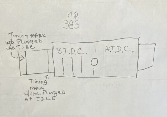

Got back from phx.this morning and just put the timing light on the warm engine w/plugged vacuum line and the crude drawing says it all. Did not check the upper vacuum port on the carb. I heard it doesn’t kick in till you go off idle. The bottom is where this carbs vacuum line runs to the distributor and it is constant vacuum. Lossened the distributor hold down clamp and with the vacuum line plugged and moving the distributor so the timing mark would come to say 10-12degrees on the plate the idle dropped a bit…I take it that is normal?
You disregarded using the upper port like the manual says because someone gave you false info. There saved you the reading.

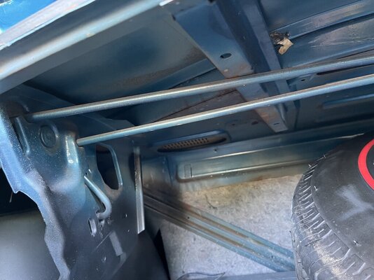

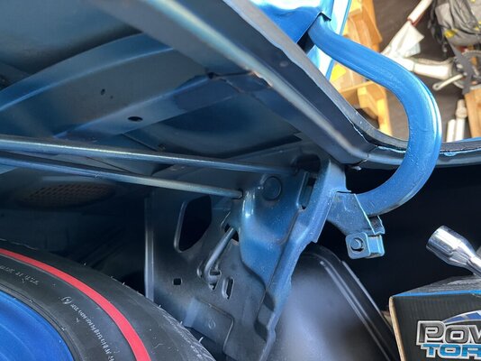

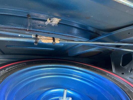

Hey Woodwiz, would you mind taking some pictures of the trunk lid hinge torsion bars? My car came with them laying in the trunk and I'm having trouble figuring out how to reinstall them.
Dan
