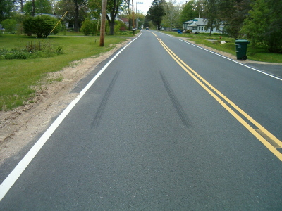

Weird that your car wheel hops. Mopars are not known for that, even really worn out stuff doesn't wheel hop. My guess is shocks. I would try a set of adjustable drag shocks from summit racing. As an added bonus it will ride nice. and they are cheap. Back in the day my Dart ran 10.80s with a 1.40 60' with worn out original 318 springs and a factory pinion snubber, no wheel hop.

I added a clamp to the front and rear of each spring and it took care of the wheel hop. The Springs have about 5000 miles and are Hemi Springs with new shocks . The 440 has been rebuilt 425 HP 500+ Torque that might add to the Issue for sure
