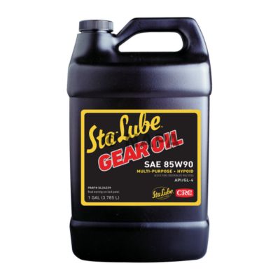

This is what I bought (from Napa).
Sta-Lube SL24239 API/GL-4 Multi-Purpose Hypoid Gear Oil

Drained the 140 and installed the 85W90. Still has a slight clash from 1st to 2nd, but it always did when cold. I suspect a little wear on the synchronizer ring. Smooth once warmed up. For future reference, 90 is the way to go.
