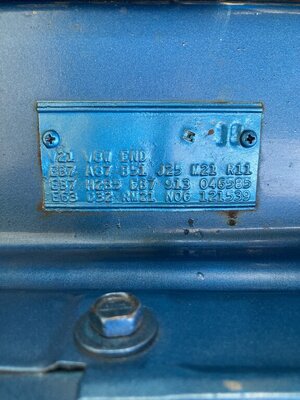

I have a 70 RR with what I think is a non-numbers matching 383HP. Just to be sure where should I be looking for the number to fit the vin# or fender tag? And of course the tranny as well?

From those numbers how do they decode? Is it linked to the vin# or the fender tag or both??

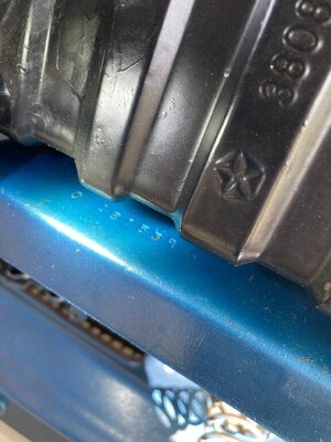

on a flat of about 3” long, right above the oil pan rail in the passenger side, is the place where they stamped 69 and later motors. The VIN, or partial VIN should be stamped there, with at least the character size, date digit and the last 6 digits of the VIN the motor was destined for. This should match your body numbers and dash VIN.

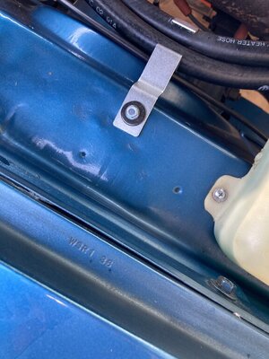

Well no match on the motor. But strong on the tranny. The radiator support has the vin from the dash and here’s a number from the top side right fender engine bay.
