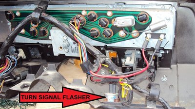

You were right on it! The small can had three blades instead of two and it is the delay for the ignition light. I found both flashers, the turn signal is to the left of the steering wheel. For a few minutes I couldn't get anything to work but then I jiggled the key in the ignition and suddenly every thing worked fine. I guess I have a dead spot on the ignition switch.

Hi there:
I realize it's over 2 years since you posted. I am impressed by your picture. A question, where is the emergency flasher? I understand there are 2 flasher relays; if I read the schematic correctly, they are identical. Thanks.
