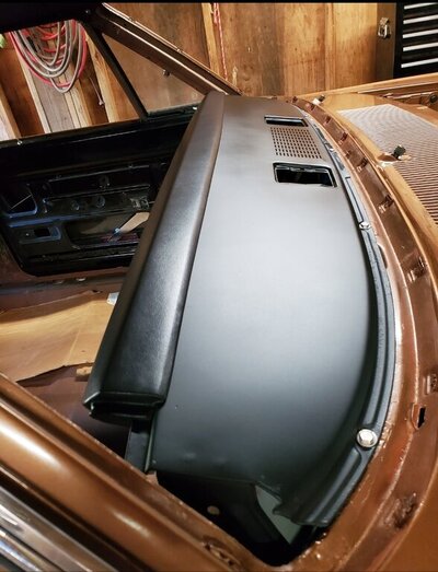

Reached the milestone of dash frame install.
Yeah!
Before I go further I'm freshening up the pads.
SEM .
"Satin" seems more like my other cars.
(They are undyed.)
Dash pad does have a sheen.
Less glare?
Should I use gloss?
Pictures for a general idea.
Never shows exactly.
Thanks.

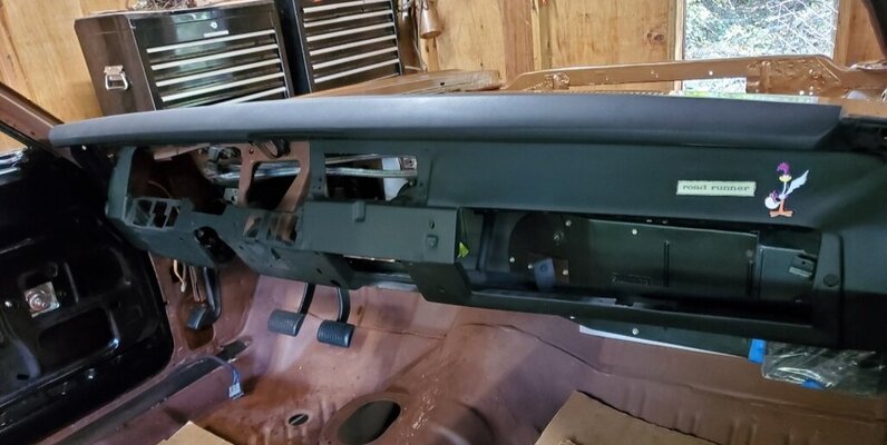

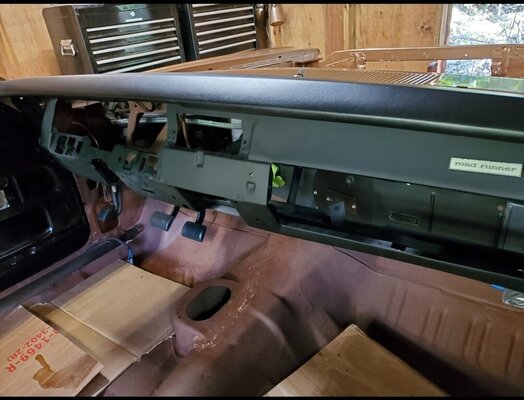

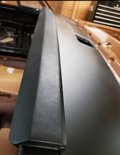

Pulled the frame back out to remove the pad.
Wasn't happy with the consistency of the sheen.
Too flat due poor application.
It was the way I applied the dye.
I've used it before and have learned that to get an even and correct application you have to be careful and spray evenly one coat and let it completely flash off before applying any more.
You can not just spray one place you may have missed during the pass.
This is "satin" which looks very good.
Not too shiny.
I resprayed the other pads to match.
Much better than gloss.Screenshot_20231003_203740.jpgScreenshot_20231003_203753.jpg

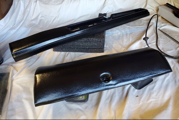

Did you check with for paint one. He sells rattle can paint. If you are happy with it,OIP (4).jpg then go for it. I just say it is your car and build it like you want it. Was trying to help. I know a pint can of the paint is not cheap and time to get it is long. Enjoy the car and drive it. LOL. Here is my glove box lid looks like my dash pad.
