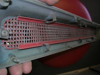

These are the real deal from my car, were some black? maybe on a red car they might have been. Mine was blue and then painted silver over the emblems and everything so there is a hint of silver on them also.

Hard to find a good hand model these days... :lmao:

Where's Stuart! :basketcase:
