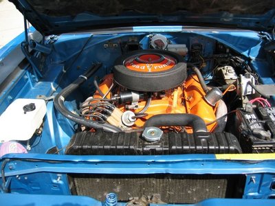

Everything is body color under the hood and including the radiator support. Then you use flat black on the front as seen in this pic. I will defer on the hood stripes to someone else.

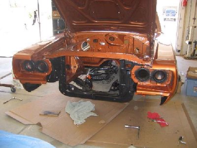

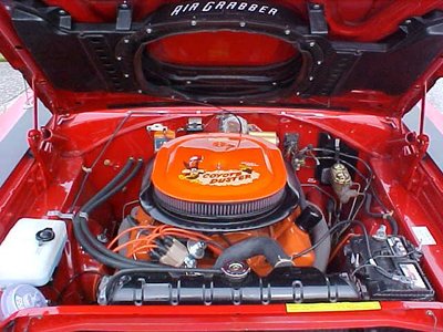

[attachment=0:1nlbyjbl]stripes2.jpg[/attachment:1nlbyjbl][attachment=1:1nlbyjbl]stripes1.jpg[/attachment:1nlbyjbl]All the original V21 hood stripes I've seen have the gap between the hood and fenders painted black (organisol) also, even the edges of the hood all the way around. I re-did mine awhile back. There should be a couple of pics showing the hood open and there you can see how the black is painted on the fenders. The black also goes all the way under the windshield trim. Here is a link to that thread.
viewtopic.php?f=11&t=1753
People tend to paint them a little different. Here the red one does not continue the black on the fenders as far as mine, while the blue on does. Lot of pics out there on the web to look at..
